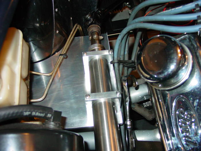

[IMG]  [/IMG]
HI Jay,
hope to see you at the round up. Glad to hear the sheild helped you with the heat problem. I know it has helped my car.
Ed
