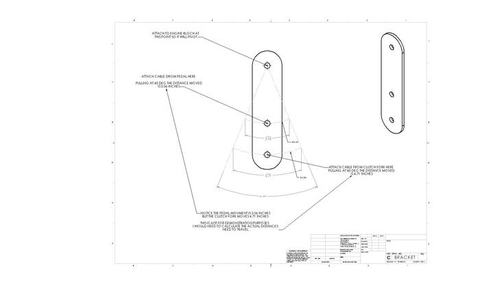

We are having a tough time with our clutch. We are running a T-45 transmission which is made for a cable clutch. We have been trying to us a powered system with a master and slave, but can't get enough throw to fulling disengage. We need about 2-2 1/4" of pull. Can someone share what you have done? If you are using a cable, how did you set it up on your pedals to get enough pull.
Thanks for the help.
Krewton
tcrist 04-24-2010 07:26 AM
Krewton,
There has been many threads on this. Some of the throwout bearings are designed to have 7-10 lbs of pressure on the pressure plate at clutch rest. As I have said before, I am from old school and I dont like it but that is what Ford and others say.
To get the cable to adjust far enough to fully engage the clutch and have enough adjustment you need to lenghten the cable sheath. DV told us the easiest way was to lenghten the tube on the front end of the cable sheath (where it attaches to the firewall). It needs to be about 6" long. That will not change the throw. I am still trying to design some sort of pivoting part to be able to do that.
What I have described anout modifing the sheath length will at least let you drive.
Double Venom 04-24-2010 08:01 AM
Terry,
What/where are you trying to put/get a pivoting point? You've lost me.
DV
tcrist 04-24-2010 12:32 PM
DV,
I hope the picture posts. If not look in my photo gallery and there is a picture of a clutch cable pivot bracked that I just drew up. If you cant read it I can send it to youe e-mail with an explanation of what I am trying to figure out.
That did not work. See the post below. Well that brought in the picture but you cant see it very well. I sent you an e-mail.
Basically I am trying to change the throw between the clutch pedal and the clutch fork.
I have tried lengthening the cable sheath like we talked about before but all that did was change the position of where the cable adjustment threaded rod sets in the clutch fork
tcrist 04-24-2010 12:34 PM
http://www.clubcobra.com/photopost/d...ot_bracket.jpg
This one works a little better.
