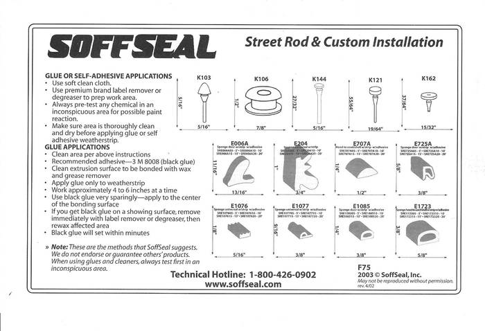

Here's what I used on my ERA, Greg:
Soffseal E707a on the doors (1/4" x 1/2" half round with adhesive)
E1723 on the trunk (3/8" x 5/8" rectangular with adhesive)
See below ...
Sam
