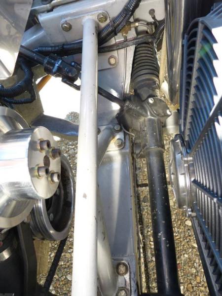

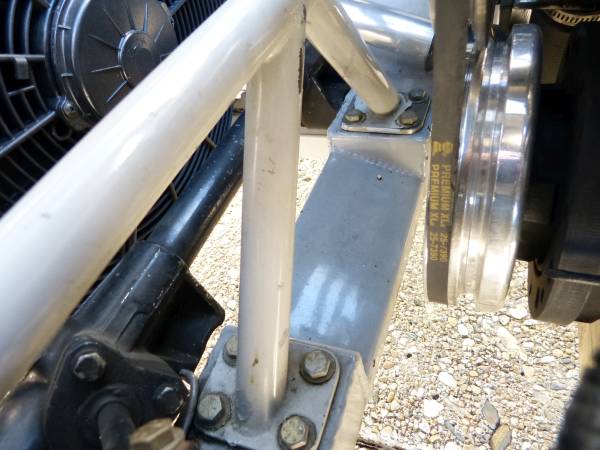

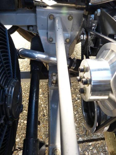

Here's pics of the cross bar:
http://www.clubcobra.com/forums/pict...ictureid=14440
http://www.clubcobra.com/forums/pict...ictureid=14441
http://www.clubcobra.com/forums/pict...ictureid=14442
I'm not a suspension expert, but my opinion is that I benefit from the sway bars on my CR Cobra. I've got them on front and rear. The car stays very flat in turns. I'm not sure how much I benefit but I certainly wouldn't remove them if they're already installed. My 2 cents, take it for what it's worth.
