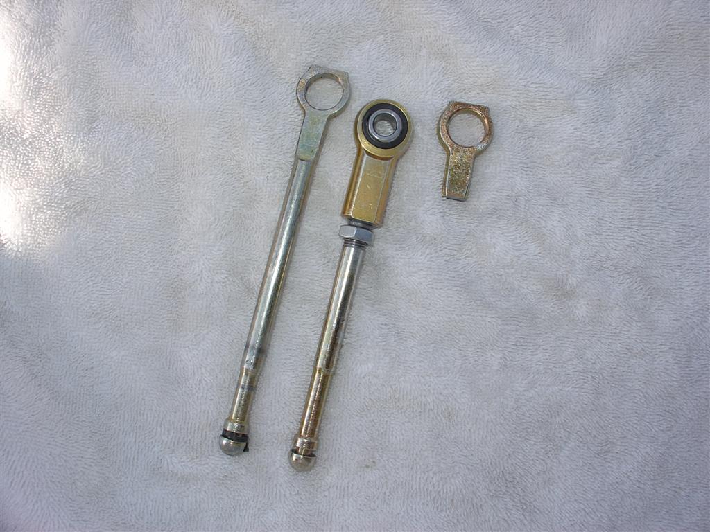

I put threads on the end of the rod for my brakes and made it adjustable. Not hard to do but I know you want the brake pedal slightly out front of the clutch. Also looks like your brake pedal ratio in the pedal box is set up for power brakes not manual. I have a pic of the mods I made to my pedal for the manual ratio in my gallery.

I'm running power brakes with 7" dual diaphragm booster and corvette style master cylinder. I've got the pedals set up satisfactorily for now, slightly higher than I'd really like but they work safely
