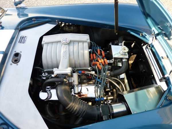

Yes, 5.0 EFI in CR1
I do have a 5.0 EFI in a mid-90's CR1.
http://www.clubcobra.com/forums/pict...ictureid=18146
It's been there a long time so I'm working from old memory on what I did to make it work. I recall that I cut about 1" out of the motor mounts. I used an Edelbrock intake manifold instead of the Ford unit. I had about 1/2" milled off the bottom manifold mounting flange where the upper manifold attaches. I had to rotate the vacuum pipes on the throttle body to clear the hood.
I think that's all I did. The EFI manifold does clear the hood which has the narrow style hood scoop. With the engine sitting lower from motor mount chop, I have to be careful going over speed bumps. But with over 25 years and about 45K miles, it's all worked out fine.

You're right about the pan being below the frame. I believe that's the case even if you don't alter the motor mounts. But yes, the sump is certainly lower if you lower the engine. I think the superior driveability of EFI is worth it though.
My engine used to have a cast aluminum Cobra T sump pan with drain plug on bottom. I never knocked the drain plug off but certainly scraped it enough to make me nervous. I switched the pan to a Canton road race pan that's a bit shorter and has drain plug on rear of sump. I haven't scraped this one although I'm very careful on tall speed bumps. There are other road race pans out there that are even shorter if this is a big worry.
I also have the suspension set for a very low ride on my CR. I like the look better and it improves the handling. While this makes ground clearance even tighter, it's all just part of the Cobra experience in my book :D
