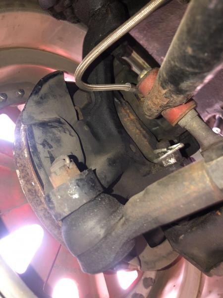

Hi from Germany,
I have to replace the tie rod.
Unfortunately there is no article number or the manufacturer's name on the tie rod
Maybe somebody can help me
Thank you

what is the rest of the suspension from? hard to see with such a limited picture.
based on the sway bar links it looks like mustang II

Yes, all Classic Roadster's have Mustang ii front ends, I believe unchanged from stock (Length) , but if (rbgray) Rob could chime in, as he just rebuilt his front & rear sup. he would tell you for sure . Cheers Tom.

I believe the tie rods are standard MII. Review the build book as the tie rod ends of the Rack need to be shortened by 7/8"
