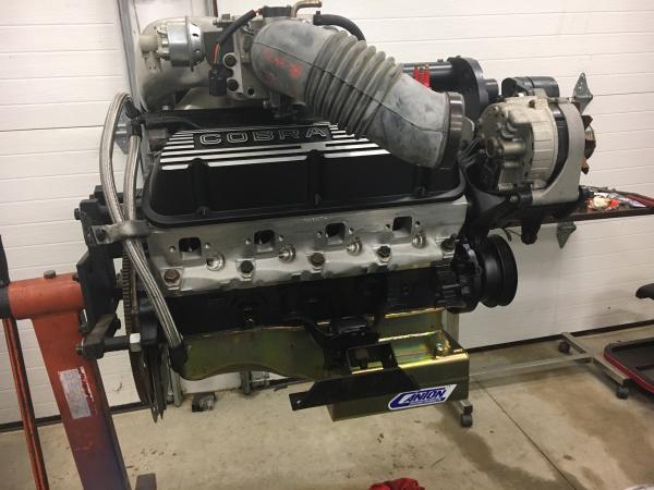

I have a low milage 5.0 that I added TFS Twisted Heads, extrude honed early EFI lower, port matched to the heads (which have a stage 2 porting job), Much larger fuel rails & injectors, bread box upper, 75mm TB & 80 mm MAF, and the CR headers (modifying the CR mufflers to more free flowing mufflers)
I can now return to a more stock style hood scoop. I am expecting somewhere around 325HP since it is the stock cam.
