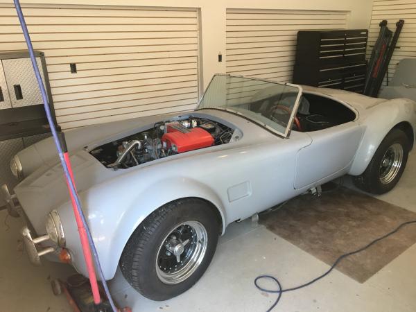

Trying to figure out what to do for tires & wheels. The CR originally came with 8 X 15 with 255/60/15 tires. The original are justa black center with polished rim. Not very attractive.
I had purchased, used, a set of 5 pin knock off Halibrand style Cobra II wheels. They are 7.5 X 15 & 9.5 X 15. The front sit fine with the adapter hubs. But the rear are sticking out 2". I spoke to Vintage Wheels, he had great experience with what I have. But no real solution without replacing the whole set. He said I could shorten the rears end to accept the wheels. Or, I can try to find to more of the front wheels and he can modify the back side of the rims to fit. Both ideas are about the cost of a set of new rims.
The Cobra II wheels look like what Superpreformance sell. They have 6 spokes instead of the 5 spokes that Vintage Wheels sells. I have looked on the web and cannot find any more Cobra II wheels used.
My other choice is to install a set of American Racing's Torque Thrust M chrome wheels. I already have the rears (new) that I did not sell with my 67 Mustang. They are 9 X17 for the rear with 274/40 17 tires. I can get the right size front wheels and tires. Like the splash of chrome with the paint and chrome side pipes. It will be easier, going forward, for tire choices with 17 wheels.
Thoughts?

After a winter with travel, health issues and helping friends suffering their own health crisis, I am back on trying to finish my project before summer arrives.
One of the items I have struggled with has been what to do about the wheels & tires.
As shown above, the Trigo Cobra II, 5 pin wheels I had purchased used quite some time ago are too wide for the narrow hipped CR1.
I reached out to Curtis at Trigo about acquiring 2ea 7 1/2" rims for the rear since they would fit under the rear fenders. He informed me that what I have are the earlier, lighter gray wheels with the rougher finish on the centers. What he sells today is a darker gray and the finish is very smooth. He did not think I would be happy with the difference.
I considered removing the rear end and narrowing it 2 1/2" per side to allow the Trigo wheels to fit. This would fit the 9 1/2" rear rims under the car.
I thought about purchasing 4 new wheels from Curtis that all match, but as I looked at the available better performing tires in 15" sizes, I was not satisfied with the compromises.
Plus, the cost of 4 new wheels and tires for a sub-$40k value finish kit just did not make sense to me. I already have invested more dollars that its finished value will be, typical for these cars. But my choice on this car was more about me being able to comfortably fit that trying to closely replicate an original car.
So, I am going with a Torq Thrust wheel in a more modern sizes and available choices for tires.
And yes, I did struggle with the non-Cobra look. But I decided "it's my car and I am trying to please the real boss- my Wife". I had a pair of new Torq Thrust wheels with tires left over from my 67 Mustang which I sold last fall that were too wide to fit (seems like a repeating problem). I decided to mount them on one side and see how they look. Decided I was happy with the look and she much preferred them. So, I ordered the matching fronts in the correct size and they will arrive tomorrow.
With that said, and before you all start to "Flame" me, I want to let you all know that my Trigo Cobra II wheels are for sale. I have the pins. hub adapters. spinners and wheels. They are in very good, but not perfect shape. They are previously used. They have already been drilled for safety wires. They ship in boxes, one box per wheel.

I did consider narrowing the axle. It was going to cost about $900 by the time I had the housing shortened, have new custom axles made, and convert from the C-clips. Then it was another $1,400 for 15" tires that would perform decently.
I ended up with the Torq Thrust M wheels in a 8X17 size for the front to match the 9X17 rear wheels. This way I had a much better choice for HP tires.
And the cost for the pair of wheels & tires were about $1,000.

I finally went with American Racing Chrome Torq Thrust M wheels in 17x8 & 17x9.
The fronts bolted right on. The rears had quite a bit of offset so I used a 1 3/4" centric hub spacer.
The tires are 235/55ZR17 & 255/50ZR17. I wanted the higher sidewall profile to not have it look like one of the Hot Wheels custom Cobra toy cars.
