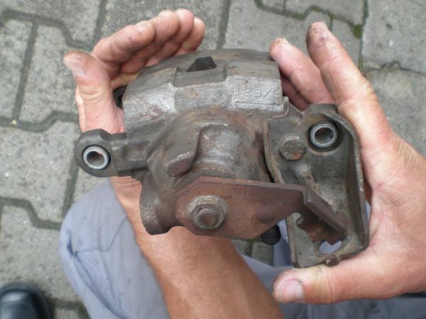

Hi,
I am from Germany and 3 years ago I bought a used Classic Roadster.
Now I have the problem that one break calliper is broken and I do not know what type it is and who is the manufacturer.

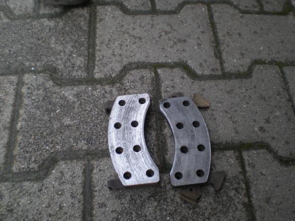

The same problem are the break pads.
So maybe you can help me.
I attached some pictures.
Thank you
Thomas

1997 is after Don changed the brakes to Corvette rear brakes. (I assume it is a rear caliber?) (Yes I see on the tag it is CR LTD, but Don and I were both trying to help out the new owners to upgrade the cars.) I think it is a 1997 GM Caliber. Somebody set me straight! Thomas take your caliber and your shoes to a good parts store-they will be able to ID for you!

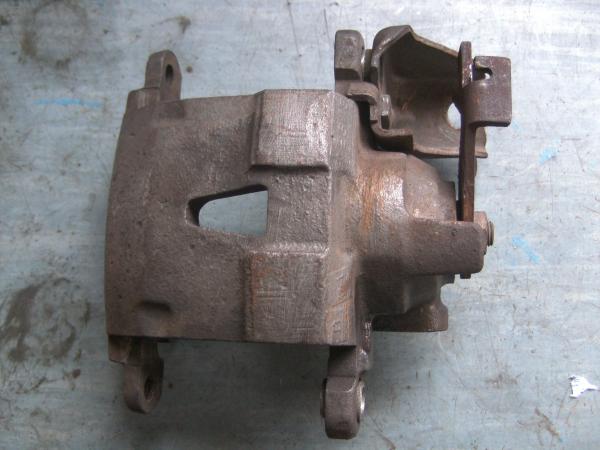

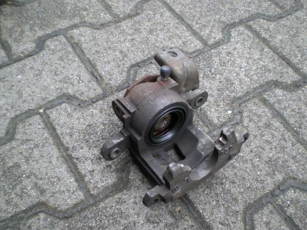

Hi Ed, it should be a rear caliper indicated by the bracket for the handbrake cable, or isn't it?
Also, there is a gear inside the caliper which could be a ratchet mechanism to adjust.

Thomas, try faxing a copy of your brake pad outlines to the brake people in the UK.
Merlin, Demon Tweeks, ATS..
Dominik

Hi,
>>Hi Ed, it should be a rear caliper indicated by the >>bracket for the handbrake cable, or isn't it?
>>Also, there is a gear inside the caliper which could be a >>ratchet mechanism to adjust.
Dominik, thank you this is correct.
Attached some more pictures

Thanks to all for help
Finally a german parts house found it
https://www.usparts-shop.de/nShop/Shop/?Art_ID=51200

Old 06-24-2009, 05:18 AM
Join Date: Jun 2009
Location: Germany, fl
Posts: 16
•1979-1985 Buick Riviera
•1979-1985 Cadillac Eldorado
•1980-1985 Cadillac Seville
•1979-1985 Oldsmobile Toronado
