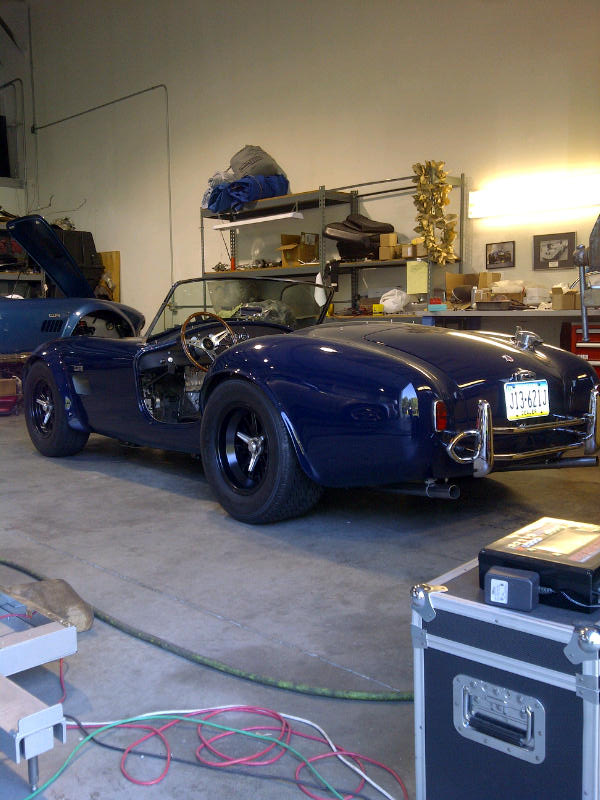

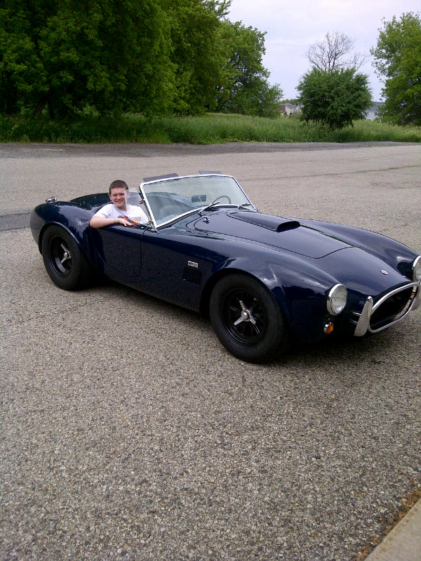

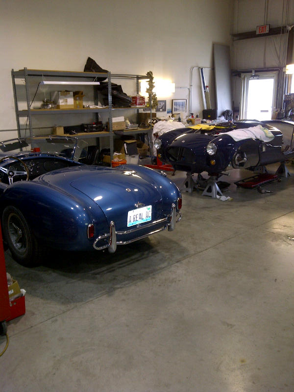

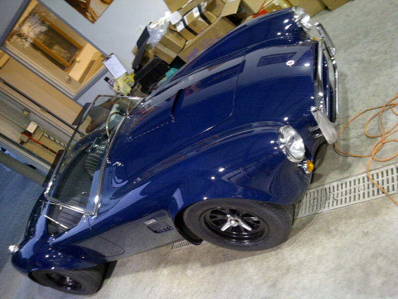

At DON HOEVEL RACING in Lakemoor Ill, we are converting a Kirkham SC to a street 427. Fresh paint, more original Ford parts under the hood, and anolog Smiths gauges.

The owner is thinking about getting a set of Sunbursts. Right now we powdercoated the Halibrands semi gloss black and mounted Avons.

Leaving the SC flares and gas cap, though?

Like to look of no scoop but the 460 needs the space to breath.First time I saw a Cobra with under car exhaust loved the look,for me it showed the lines of the car better.Then after riding in a couple of side exhaust cars knew for sure what my car was going to have.Instead of going over the rear just inside the wheel house made clearance through the rear crossmember with filler then straight out the back under the differential.Now can remove complete exhaust from collectors back in one piece.
