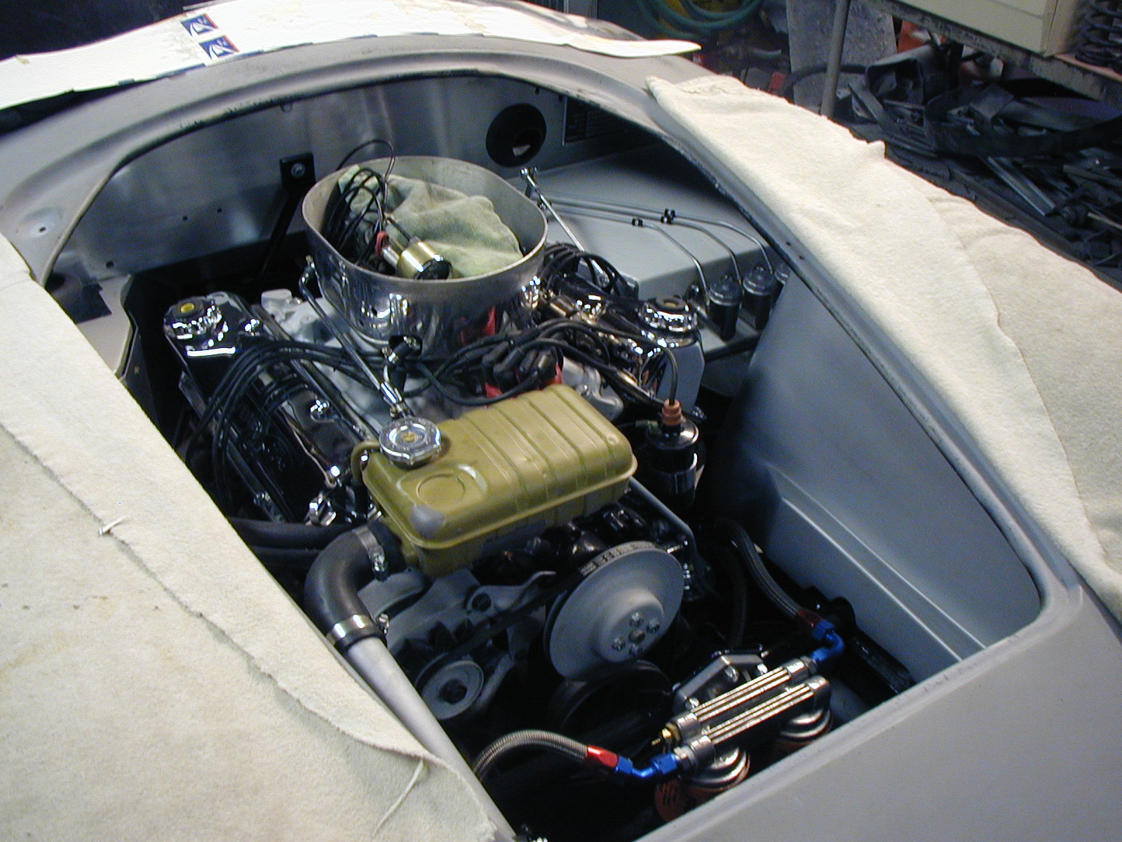

Purchased a body and a frame in 1989 from NAF, been collecting parts and working on various parts off and on over the years. This past year I’ve been able to finish the chassis and suspension mods. Bolted enough parts to the chassis to take it for a drive…..Now getting the body on and working on getting all the fidly bits sorted out and bolted on. Then on to wiring and paint. Not sure if anyone else has taken as long.

Sorry to hear about your body troubles, I thought your car was up and running. I always liked the body and construction, just not the work they did on the gaps around the doors, hood and trunk. lots of time fixing some guys excessive sanding when mounting them. Also redid the inner fender panels to fit the frame better, redid the trunk to make it wider and deeper, cut the corners off the foot boxes for a little more header clearance and moved the roll bar and windshield forward to fit the top and side curtains. Also cut the crooked hood scoop off for a Bolton one. You tube link for giant go cart ride...

Got the wiring done except for the headlights and front signals, Everything worked but the Tach, works fine after you give it the Smiths gauge poke start. Finish up a few things and then put some primer coats on it....Youtube video link of the start after pluging the dash in.

Got the wiring done, moving projects around in the shop to start prepping the car for some primer. Couldn't resist a short drive. Link to You tube video.. NAF Cobra wired moving for prep for primer - YouTube

Increased the fiberglass thickness at the door sills from 1/8 to 5/8 to better contact the weather strip. decided to put the seal on the door rather than on the thin fiberglass lip on the body. It also gives me a wider area to attach a proper scuff plate. Also built some new mounts for the door latches. Pictures in gallery if inserts don't work.
