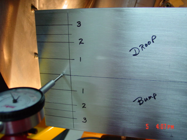

Morris 03-12-2020 12:48 PM
The lines on the side of the plate have to be in ink so your Dial indicator will move over them without falling into a scribed line and cause and error in the readings ......
Later we added a 1/2" mark above the 2" mark on both Bump and Droop.....

And of course you need a couple of Dial indicators.....
These we got from Enco...... $20.95...each.....
You want the 2" kind because it allows the pointer to reach the plate and also you want to set it at the 1" mark and at depending on the hub's direction of travel will go in or out...... so on the 1" mark we can measure the amount of movement we have and which direction it goes....
http://www.clubcobra.com/photopost/d...mp_Steer_8.jpg
