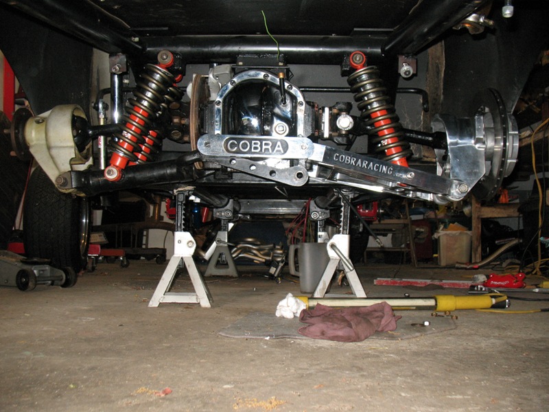

Here's a photo of the ERA setup with outboard brakes.
DonC

http://www.clubcobra.com/photopost/s...//ppuser/19425
Have a click through some of Rich's pics. He shows some great comparo shots with either side and some good info on what hubs he used for the outboard conversion etc. .
I only used George's control arms and to get outboard brakes, I used Jag XJ40 hubs which needed the use of different bearings with shims all bought from McMaster. You can used the stock brakes or go custom like I did using Wilwood pieces with a fabricated bracket to accomdate the larger rotors.
Cobrarich
