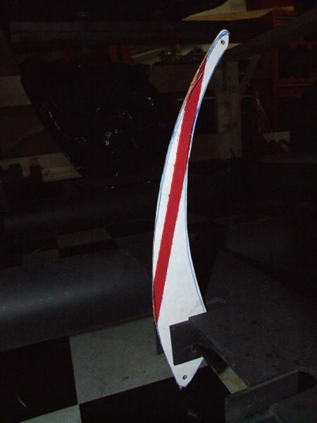

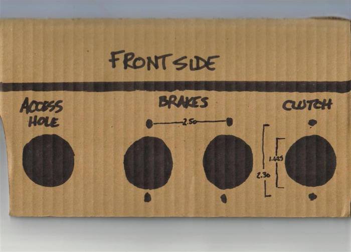

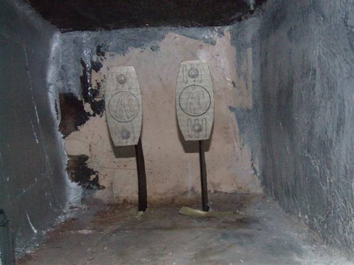

Does anyone have any detailed photos, info, suggestions regarding the floor mounted brake and clutch pedals used on Contemporarys? My frame is set up for the floor mount, I am leaning that direction instead of the swinging pedals. I have made up a couple of a templates that achieve a 6.5:1 ratio. The frame setup suggests a pedal with the pivot point between the ends are required. The master cylinders appear to mount on the back side. Any ideas on types/sizes of master cylinder? How far the pedals should extend above the floor?
