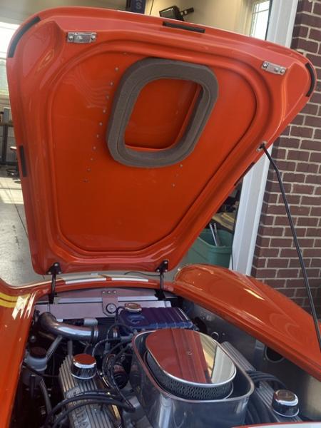

I purchased a sheet on 1.5” thick dark gray foam online and cut it with an electric turkey knife.
It looks like some of the vintage Cobra race photos. It is glued to the bottom of my hood.

For my car with FE engine I used Play-Doh modeling clay to check the clearance between the lip of the turkey pan and underside of the hood. In my case it was 3/8"-1/2" and I just bought some peel and stick epdm foam to place around the top of the turkey pan.

Further - my hood to turkey pan is less than 1/2” at the front and more than 1 1/4” at the rear.
