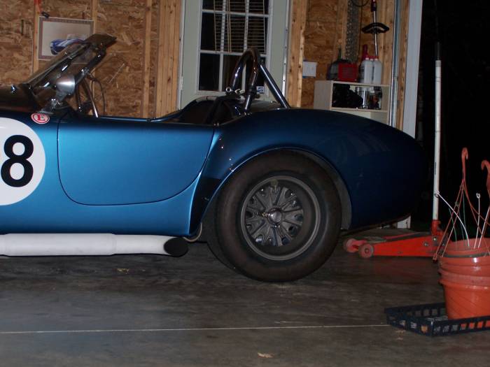

Like Jeff said...... "Old school look"! Just tried one to see how it looks.

I like the look.... I think! The white centers, although giving it the FIA look, were to me just too "pretty". I have been striving for the vintage magnesium look and finally found this color. Think I'll do them all. This one is masked off with painters tape and painted over just to get the feel for how it will look. (THANKS JEFF!!!!!)
Dan, I don't recall the name or the color, but it is natural cast look and high heat for engine parts. Also oil and brake fluid resistant. Sprays easily and completely flat. Sure it will look more like corroded Mag when it gets dinged up and dirty. Will get a part# to you tonight if you are interested.

Okay guys... the paint is from plasti-kote. Color is "Rebuilders Cast Finish" 500 degree coating, resists oil, break fluid and gas. Just came in from the garage, figured I would scotch-brite off the the polished part and pull the tape... got to have it ready for breakfast Saturday... much to my pleasent surprise, it doesn't come off very well. What mean is that it lightly scuffed through to give it an even more antiqued look. Just a few light spots that show through. Looks even better. Jeff; I'll leave it on so you can see it on Sat. Will post some pics when I have a chance to finish it up. All I need now is some bill-boards or hooziers!

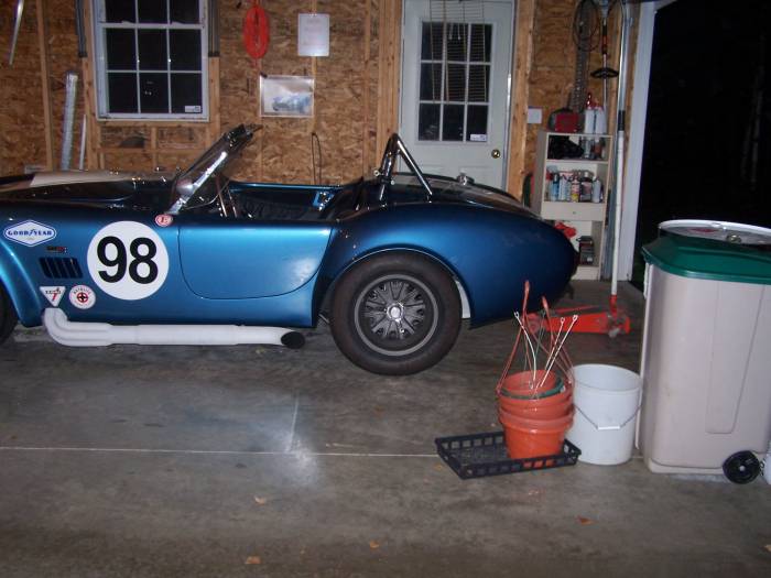

Okay guys.... Finally had a day to work on the car, painted the wheels, took out another 3/4" out of the rear c/overs and evened them up, (good bye perky butt!) and finally installed the headlight baskets that I bought for the R-Model 25 years ago.
Like a different car...
[img]
If any of you ever decide to put the HL baskets on, don't use the clips that come with them. Bulky and don't fit right. I used safety wire... worked super!
Jeff, did you do all 4 of your wheels?
Still have some more work to do on the wheels. Will subdo the out side with scotchbrite just until the alum starts to show. Also have to put another coat on the centers. Got too humid yesterday and the paint cracked some. Had to get them on the car to see the looks and check the handling after lowering it some more.
