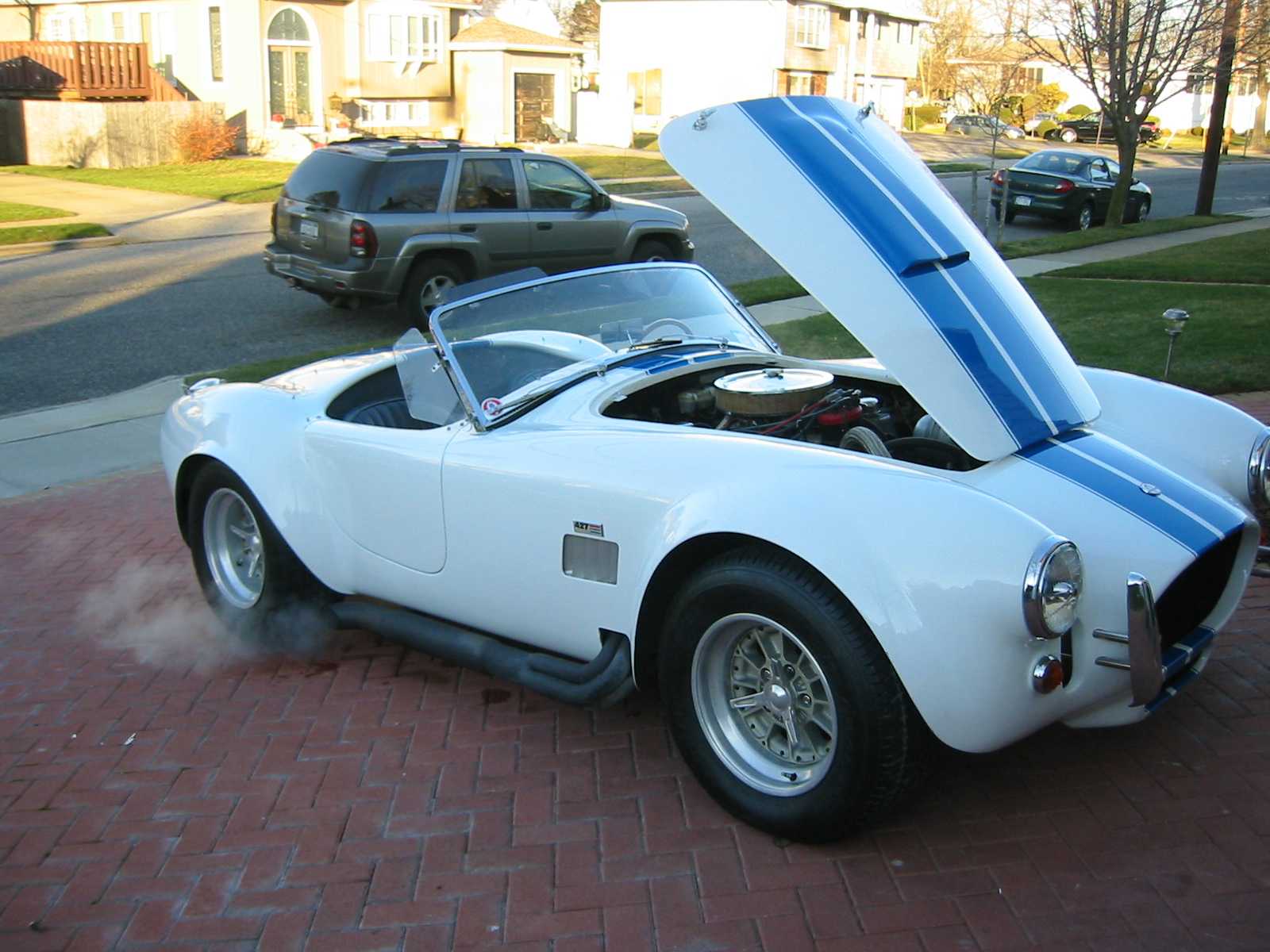

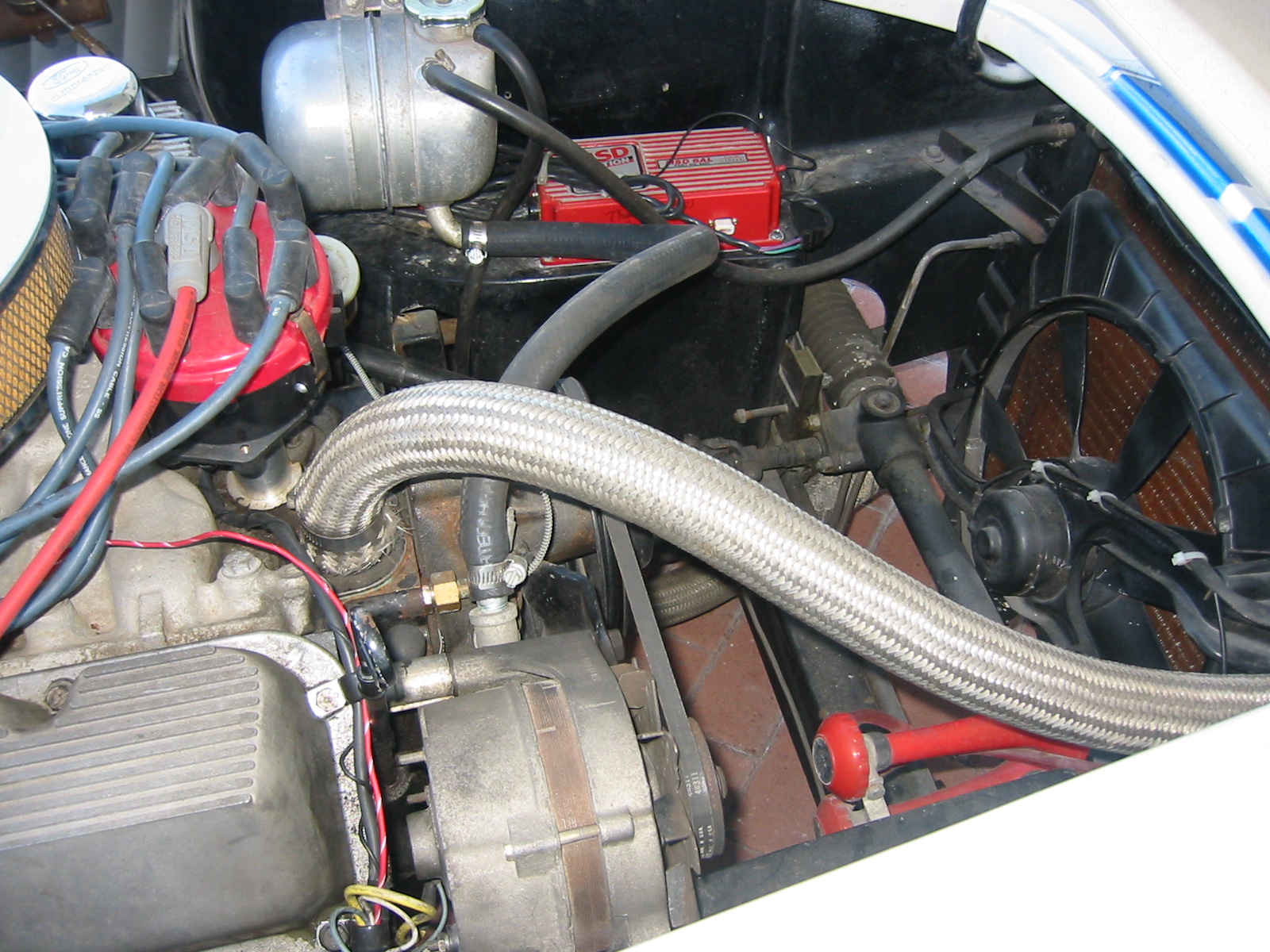

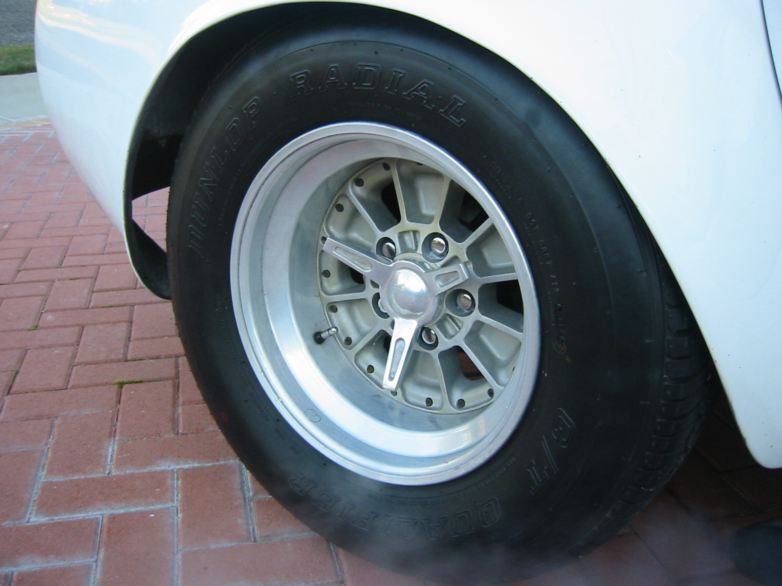

Damn, was this thing ugly! I don't like bolt on wheels, but as bolt on wheels go, these were nice ones, and I sold them quickly. Hope you're enjoying them, Hugo! Note the pristine engine compartment (UGH), and the high class navy blue vinyl everywhere interior! The guy I bought this from was hysterical - he knew absolutely NOTHING about the car. I mean, guys, he didn't even know what engine was in it. I mean he knew absolutely NOTHING!

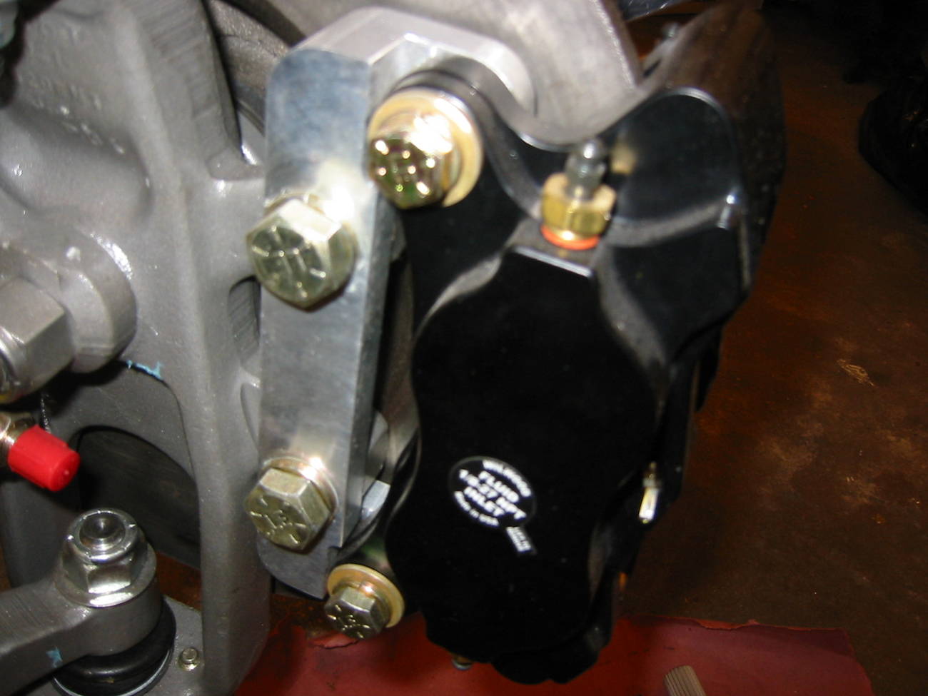

So, once all this stuff is ordered and on it's way, it's time to turn back to the car. All the de-greasing, blasting, stripping, painting, etc... is finally over, and FINALLY it's time to start assembling the beast. The first thing that gets completed is the passengers front suspension. I find an article in a Jaguar XKE forum about an inexpensive upgrade from the archaic Series 1 XKE Dunlop calipers to modern Wilwood 4 piston units. This upgrade requires the fabrication of a milled billet caliper bracket. I send the specs off to Nick Acton, and a week later, like magic, these two works of art come to me in a brown truck.
I don't have a good picture of just how horrible the suspension looked before, but here is the passengers front side now, not yet complete but close:
