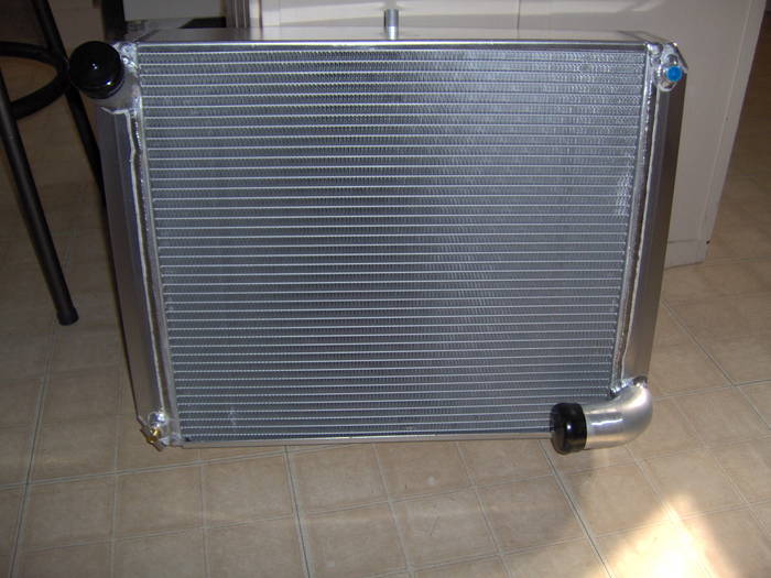

I'm going to replace my radiator. Does anyone have any suggestions about what brand and what type of radiator would work best? I'm in Chicago and none of the guys in the Windy City Cobra Club own a Contemporary so I'm turning to the guys who build and drive them for advice or even a part number. I'd like it to fit in the same spot as the original with no/very little modification.

howe racing supplied the radiator in my ccx in 1981, just bought a new one from them about 3 months ago, i had them leave all brackets and inlets and outlets off so i can mount it differently. the price was $200 plus shipping. all aluminum and the exact same as my orginal one. you can order it from summit racing HE-352 with no fill neck, cost a little more.

Are you willing to do a little fabrication or do you want a pure bolt in? If you're willing to fabricate a bit look at Jeff Gagnon's Fluidyne install in his CCX. It's laid back at an angle like the originals and makes a HUGE difference in the look of the car. The Fluidyne is a great radiator as well - it's not just about the look. The job is a bit of work but not too bad. Jeff has all the plans and instructions as well that he can forward to you.

Jeff, Call Griffin radiators. They are great to work with and will build you a radiator to fit and work for your application exactly. Visit their website. They are knowledgeable and professional. Check out their website but call them to get a quote.

I believe the radiators were laid back to get a large radiator in a small nose and also to make more effective use of airflow across angled fins for better heat transfer. The CCX radiator is a counterflow unit I believe if you have the factory one. That is it has a blank plate halfway down the tank and both radiator hoses on the same side. If you're specing a replacement it should be to your dimensions and horsepower of the motor. We had a couple of different Cobra radiators made by Performance Rod and Custom that are really nice. He makes me very humble about my aluminum welding.

I use a three core Howe Racing. Living and running in Arizona in the summber time, a good radiator is essential. It's the second one I've used from them. My 428 runs at 175 on the hiway without a thermostadt. I've added a 187 thermo and it now runs about 190-195 all the time. I swear by Howe Radiators.

Recently built two 70 Chargers.BOth 440 cars.Used Griffin rads in both.On a 90 degree day,on "break-in" temps never rose above 200 degrees.Quality product.Expect to pay around 5 bills.

No, top left and bottom right on Fluidyne.

I decided on a Griffen dual pass with two rows of 1 1/4" tubes. I'll update and let you know how it works out. Thanks for all the suggestions, as usual. You guys always give me great options and ideas.
