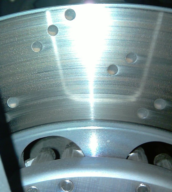

The Rotors as obtained from SPFs supplier originally are modified to fit the coupe -
here is a list of mods that they do ;
1. Drill them out a Ford / Dodge / Mitsu /Mazda bolt pattern of 5 x 4.5" for the lug/pins to go through, these new holes are also countersunk a bit for the base of the Pin Drive lugs to screw down on top of them.
2. Bore/Mill out the Hub register (big center hole) to fit the hubs on the coupe, radius the backside cut so it mates to the hub and seats ( sits flush )
This took some time to do and we had to have the centers done at a Larger machine shop with a larger lathe to bore the center out precisely, and have it be a concentric circle with the hub.
We then found that the Calipers originally had a 2 piston single sided front, with a single piston , single sided rear caliper. - in the Z06 (2006) this was upgraded to 6 pistons front, 4 in the rear, - I know Jeremy Clarkson keeps saying more is better, so we went with it.
The SPF calipers on the coupe are basically stock with script engraved in the fronts. since mine were damaged, they function OK, but look like hell even after scrubbing and painting - So we went with the C6 Z06 Calipers.
See the below photos for detail, - questions welcome.

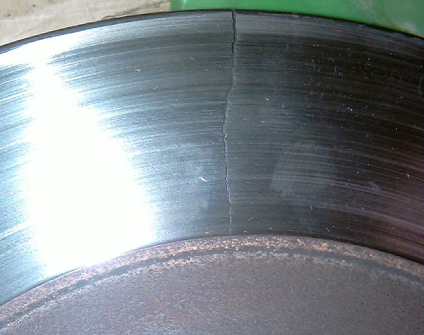

Well, it looks like the stock rotors really couldn't hack it on a racetrack after a 40 minute race:
So, I got some Performance Friction items with the C5 Corvette fitment. After a bit of boring out the center hole and counter-sinking 5 holes for the pins, they are now fantastic.
I have kept the original calipers for now, as they do a fine job.
