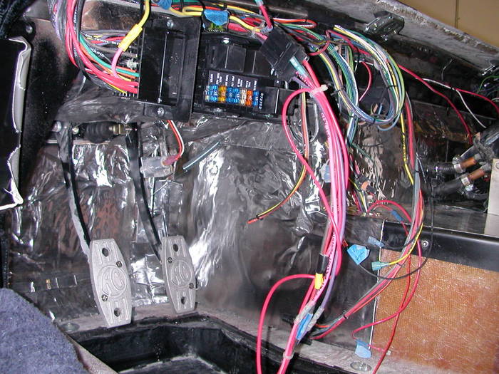

I got the taillights and the tag bracket / light, rear hatch gasket installed. I'm going to make a new frame for the rear glass.
Coach installed the gas cap, hood gasket before he had to leave for Gulf Conference baseball play offs starting Saturday in Memphis, Tenn. Talk about mixed emotions, win a division championship or finish the Coupe.
Coach bought aluminum foil peel and stick insulation. I installed it on the firewall and on the sides back to the doors. We will wait till the head liner is installed to finish the rest. It is a heat and sound deadener, 12" x 20" thin aluminum foil / rubber stuff, $5 a square foot. I did not look at the name on the box, I just put the stuff in car. But I like it.
