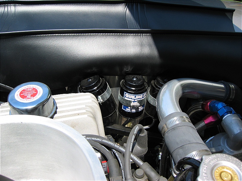

Old 10-06-2009, 09:47 AM
Posts: 22,025
Originally Posted by RedBarchetta View Post
But, again, most average Joes wouldn't notice this little detail.
I don't know about that. At my last show I had four different people come up to me and say that their favorite part of the car was the little Girling decal on the black can under the hood.
