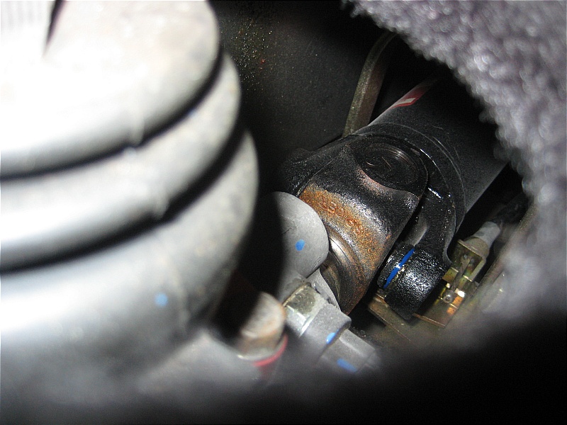

I think you'll find the rear one to be pretty easy -- it is on my car. And I think with a long extension and a swivel head that you can get the front one via the shifter boot hole. Somewhere I've got a picture that I took of the front u-joint through the shifter boot hole. I'll see if I can find it and post it.
patrickt 10-15-2009 05:34 PM
Here's a Shot
OK, this is what it looks like through the shift boot hole. I think you can do it:
http://www.clubcobra.com/photopost/d...rearujoint.jpg
PeteF 10-15-2009 06:21 PM
grease fitting access
Fantastic! Thanks for the help and photo, I really appreciate it.
