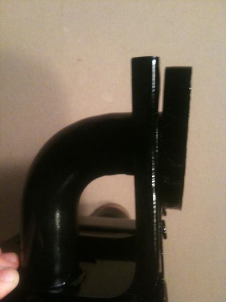

Okay, I think I found the problem. Take a look at this photo:
http://www.clubcobra.com/forums/pict...d=1944&thumb=1
Notice the difference in the angle of the plate and the mounting ring? if the ring was flush with the plate it would be at an angle where the tank would not interfere with the distributor.
Here is a close-up view:
http://www.clubcobra.com/forums/pict...d=1943&thumb=1
Can the tub be bent so that the ring angle will align with the plate, or would that damage something? Just looks like a sloppy job putting the thing together. I really wish people would take more pride in their workmanship.
Your pics did not get posted properly.:( I don't know whether you can bend it or not, but I will tell you the technique I use in circumstances like that. I just go ahead and try and bend it; if it brakes, it needed replacing anyway since it wouldn't work without bending it to begin with. That theory has worked well over the last 35 years or so... but I've replaced a lot of parts.:p

tgitchel 11-05-2009 07:45 AM
Originally Posted by kgs365 (Post 998596)
im watching this thinking....darn there goes another way to save a few $$$$.....easier to write the check to Peter!
That's the problem. I did get it from ERA and paid $450. I don't know if I really want to risk braking it by bending it.

Gunner 11-05-2009 07:51 AM
Maybe Bob has a comment now that you've established the apparent problem. I would get his input (or someone's, by calling ERA) before getting out the hammers.
patrickt 11-05-2009 07:52 AM
Originally Posted by tgitchel (Post 998599)
That's strange, I uploaded them to my gallery just like the one in the first post. I can see them fine.
They work now. Strange. Anyway, I would just go ahead and bend it. If it brakes, just tell Bob it came in the mail that way -- he'll never be the wiser.;)

tgitchel 11-05-2009 07:58 AM
Haha, yeah assuming he doesn't read posts in this forum... The shipper damaged my ceramic coated exhaust, so I guess what's one more part :LOL:
Seriously though, how do you think I could apply enough force in the right location to bend the tube without cracking the solder at the mouting ring or the base of the tank? How would I even know if there was a minor crack that could get worse?
tgitchel 11-05-2009 08:02 AM
Originally Posted by kgs365 (Post 998605)
just send it back overnight!....they will fix you up !
That might just be the best solution, but I would rather not. Since they will need to "repair" this one anyway, maybe I will try to bend it first or just get a radiator shop to do it.
patrickt 11-05-2009 08:29 AM
Now if I were bending it, I'd heat it up first. I wouldn't use a torch, instead I'd put the part I'm bending in a pot of boiling water for a while. I'd stilll end up braking it probably 60% of the time.%/ Just ship it on back to Bob if you do.
lineslinger 11-05-2009 08:34 AM
I revamped the forward pitch on the mine when I 180'd the outlet around to the drivers side. Take another look at the picture posted earlier and note the slight forward angle of the tank toward the nose of the car. You can uniformly heat one of the solder joints softening it enough to get the tank to shift a few degrees forward.

rustyBob 11-05-2009 09:32 AM
I spent 10 years working a radiator shop and i probably repaired a thousand of those tanks, theres a reason Ford only used them for a short period of time(there not worth what they cost ) send it back and have them replace it or repair it, the bracket that runs up the back side from the tstat housing should be attached to the flange the tstat sets in and should be 90 degrees to that bracket and the tank should be about an inch out away from the intake manifold.I dont know why those dumba$$ tanks are so popular i would toss it and install an inline filler neck and not have any problems that they have and it would be a heck of a lot cheaper(450 bucks ???).....somebodys getting bent over just have that look of originality.........
