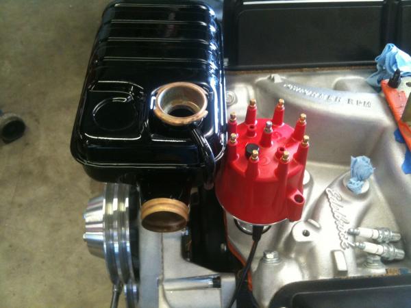

Issue with Expansion Tank
Am I missing some sort of spacer, or is the expansion tank supposed to butt up against the distributor cap? %/
http://www.clubcobra.com/forums/pict...pictureid=1918
rustyBob 11-03-2009 11:50 AM
no it does not sit against the dist. there should be a thick flange that the thermastat sits in and that helps space it out from the dist.

rustyBob 11-03-2009 12:09 PM
thats not a seperate part that i know of it should be made to the tube that the tank sits on.
Jim Holden 11-03-2009 12:11 PM
Which distributor do you have?
Jim
patrickt 11-03-2009 12:20 PM
Does your tank look like this one from the Gessford site? I'm pretty sure that the ERA ones are not only shortened but spaced out a bit. I think Bob told me that the tanks they have now are made from scratch for them.

tgitchel 11-04-2009 08:27 AM
Thanks for all the replies.
I got the tank from ERA. The distributor is an MSD (I got the model number off the Keith Craft web site). I would have hoped, for the price, that it would work without having to fabricate additional parts.
Jim Holden 11-04-2009 08:32 AM
It depends on which distributor (ie; narrow or wide) that you got from MSD.
Again, which one do you have?
lineslinger 11-04-2009 08:33 AM
Although components are reasonably interchangeable you sometimes have to be flexible when performing a build...part of the deal I think. The spacer is relatively easy to fabricate.;)
Gunner 11-04-2009 08:50 AM
My car has the narrow MSD distributor and the ERA-supplied expansion tank, which has a spacer of about 3/8 thickness where it bolts to the intake port. There is about a quarter inch between the lip of the tank and the nearest spark plug wire boot.
The only reason you should need more space is if you're using the wide MSD distributor, or if your intake has an unusually deep inset on the thermostat port.
If it's the former, my 'umble suggestion is ditching the fat-top for a standard configuration disto - the look will be more era-correct and the only real advantage to the wide distributors is reduced crossfire at very high RPMs. As FEs top out at about 6k, you're unlikely to have crossfire problems in any case.

tgitchel 11-04-2009 12:45 PM
Patrick,
Thanks for the pictures. It looks like you have the same distributor that I have, but your expansion tank appears to have a spacer that mine didn't come with. When I get home I will look through the box again to see if it's in there and take some more pitures. My air cleaner is the long, oval one with Cobra on it that you see a lot. I will need to test fit that next to see how close it comes to the distributor.
patrickt 11-04-2009 12:49 PM
That would be the MSD Pro Billet 8594. I'll take some shots up close and see if that doesn't help -- maybe with a ruler or something.
Gunner 11-04-2009 01:09 PM
Patrick's setup is identical to mine and I have fit the turkey pan and a long-oval with no problem. EDIT: I had to do considerable work to the bottom plate of the long oval to get the AC assembly to clear the trailing edge of the hood, but no problems with engine component interference.
It sounds as if your tank does not have that integrated 3/8 inch spacer - if you got it from ERA, it should have had it in place. If not, you'll need to fab or find one.

lineslinger 11-04-2009 02:05 PM
Without the spacer the edge of the E tank was just barely resting against one of the electrodes on the dizzy. It wouldn't take a much time for engine vibration to allow scoring of the rubber boot from the seam on the tank. As well I use the same oval air cleaner without problem.
This is the distance I accomplished
http://www.clubcobra.com/photopost/d...0/143_4319.JPG
Jim Holden 11-04-2009 02:08 PM
The "spacer" is a part of every expansion tank assembly. It is silver soldered to the tube to the tank when it is constructed.
Without seeing what is causing the interference it is hard to say what the problem is. Sometimes the distributer needs to be rotated because a holddown clip or other obstruction on one side or the other of the distributer is hitting the tank. It is a snug fit under the best of circumstances.
