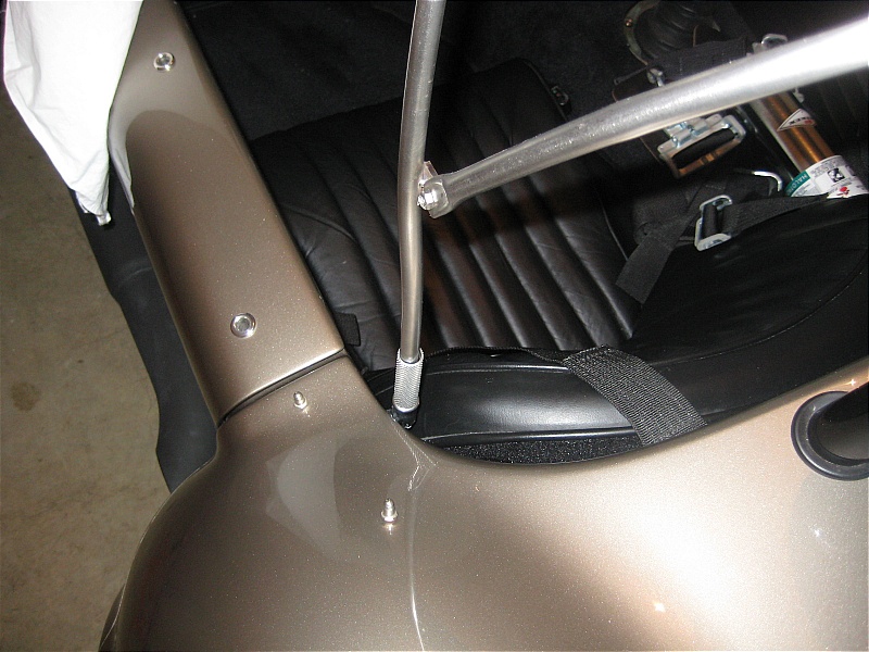

DonC 12-04-2013 06:47 AM
Don't know about the current crop of cars but my soft top bows have a threaded portion on the end that fits into the ferules behind the door that allow for about 1/2 inch of travel. That could take up any slack in a "slightly" loosely fitting top.
DonC

patrickt 12-04-2013 08:12 AM
DonC
Yep, good point. That would be these:
http://www.clubcobra.com/photopost/d...wthread001.jpg
