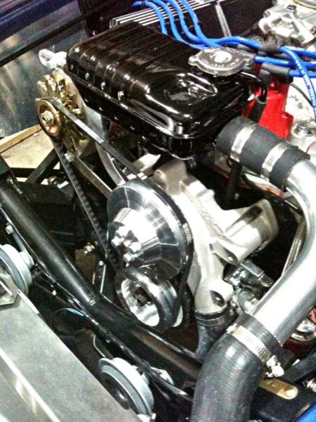

Puller fan is definitely blowing the right direction.
Looks like water pump pulley is bigger than the crank pulley, so under driven which could be a problem I guess. I do have the bypass hose installed.

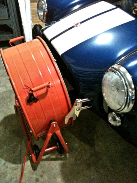

Here is the shop fan setup I am using:
I was worried about the paint on the fenders and the sides, but this fan keeps them just warm to the touch (before this fan they got very hot to the touch).

x2 on that pulley setup, take it back to stock and work from there. New gauges/senders can be the culprit so get a $50 Infrared tester like this: http://www.summitracing.com/parts/SID-MT-200/ ASAP so you can check for hotspots on your radiator and other places like the intake manifold and headers.
Its pointless to let that engine get to 230F repeatedly because even at 200F at idle something is wrong. Your car shoud idle at 185-190F all day long if its set up right. Been there, done that.
