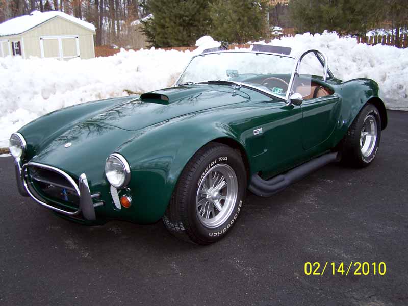

Originally Posted by mr bruce View Post
Hard to beat Bill's (mrmustang) ERA for the money. And it is completely sorted out and ready to drive. For the price Bill is asking, you could afford to repaint it if you don't like the British Racing Green color and still be ahead of a new one.
Hard to believe it hasn't sold yet.
Bob

British Racing Green with no stripes is such a classic look, I'm not sure why some dislike it so.
