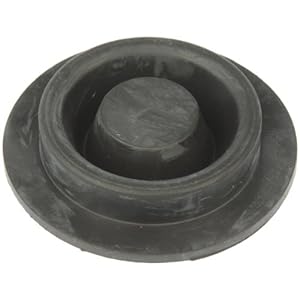

I also bought the rubber inside seals to install in the lids. Works very well - should help prevent leaks at the lids. I think this was Patrick's trick he published here.

Thanks guys. I was thinking about some rubber rings as well. Any info on those, i.e., where to get them. My issue is not that I don't know how to put it back together but I can't screw the double threaded piece back onto the nut that goes inside the can. The red material just will not allow me to start the threading process. I'll fiddle with it a bit. I just had to walk away from it.
What you want is the Dorman HELP! 42072 Master Cylinder Gasket. It fits right in the top of the Girling lids and makes a pretty good difference. Order it off Amazon: Dorman HELP! 42072 Master Cylinder Gasket : Amazon.com

I bought the rubber seals that I think Patrick recommended and them seem like they will work fine. I believe the paint is less the issue if you can stop the tops from leaking.
