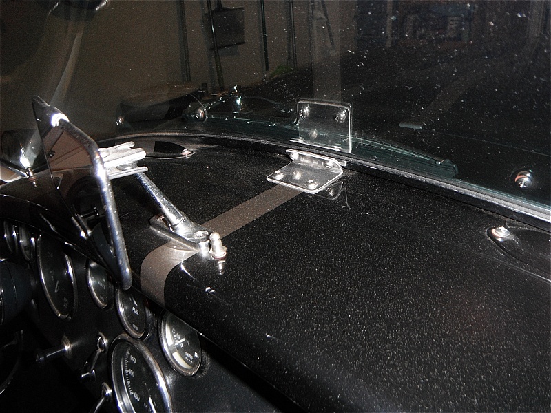

You mean this brace? Yes, your windscreen will come flying off if you don't have it. And for some reason the flash picked up every piece of dust on the cowl area. Time for the ol' California Duster....

At 130MPH the center of the glass will raise 3/8" without it.

... and if it does come off at 100+ MPH you're going to have a very bad day. Oh, those threads are Whitworth, too.

Forget the rod-that's not what you're asking about. It's ERA's bracket that Pat shows.
Get one from Bob.
Don't sheet-metal screw it to the cowl. If you use speed, it will slowly egg-shape the holes and pull out.
Mock the bracket in place using masking tape. Remove windshield. Using a long (at least 4" bit) drill two mounting holes in the cowl, straight through the second wall of the cowl. Then from below (the back side of the cowl) install 2 1/2" long (or longer if needed) hex machine screws which will protrude from the cowl. Trim them to be just tall enough for the bracket thickness and nylock nuts on top. Snug down the bracket.
If you just parade the car, snug the windshield frame legs into the chassis mounts and do without the bracket.
This is what I did with my early chassis car-don't know if the cowl structure changed in your later car. The glass is too thick there to just install nutcerts from the top so that's why I through-bolted it.
Chas.

I am asking about the ERA supplied bracket that Patrick showed.
My car has 12,000 miles without it and many with the top on at highway speeds. No issues noticed yet.
Since the bracket is sheet metal screwed to the fiberglass, I suspect it is for looks only.
I am leaning towards ordering one from Bob.

I thought we supplied that bracket with every kit...
It's supposed to be functional. I haven't noticed the windshield lifting at speed on any of our cars with it installed, but then again, every one that I've driven had it.

If you look at the marks the rubber seal makes on the cowl without one you'll see the center bracket stops the windshield pushing back.

It sounds like the bracket has some function.
I'll call Bob later this week and order one.
