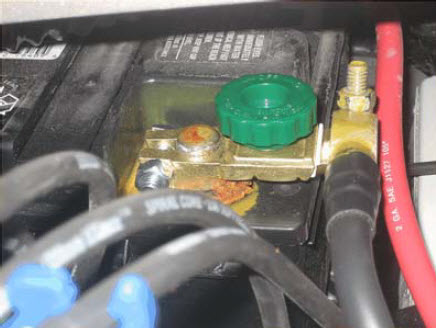

The Green Knob, works like a charm....

The green knob works quite well just take it with you. Vise grips are the only way to overcome it OR have another Green Knob.

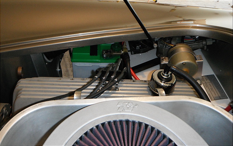

Revisiting this thread. I have a green knob but it is toward the outside of the car (under the fenderwell) and behind the fresh air hose, so it's hard to reach. I'm considering a similar simple mechanical switch I can mount on a bracket under the hood in a more easily reachable location. Anyone done this? What's the setup/switch?

I don't understand. Does it not look like mine?

Patrick,
From the sound of it, his battery is mounted the reverse of yours. A simple turning on the battery 180 degrees will work to make his access like yours.

Bill is right. Mine has the positive toward the outside of the car, which makes it hard to reach. ERA recommends it's installed this way so the cables can reach. If I turned mine around so the positive terminal is closer, both terminals would be facing the front of the car.
But I just noticed it looks like Patrick installed the switch on the negative terminal. Am I right? This would solve the problem as well.
Yes, on the negative. That is the preferred method for installation.

I'll just install the green switch on the negative. Problem solved. Easy. Thanks!

Lippy, mine is mounted on the negative terminal also . Not ideal but I've done it this way on my Corvette for years and now the ERA - with no problems.
I prefer the knife blade contact-type switch and use that on my Corvette. I have had green knob switches that sometime make contact and sometimes don't. But not enough room in the ERA to use the knife blade type.
