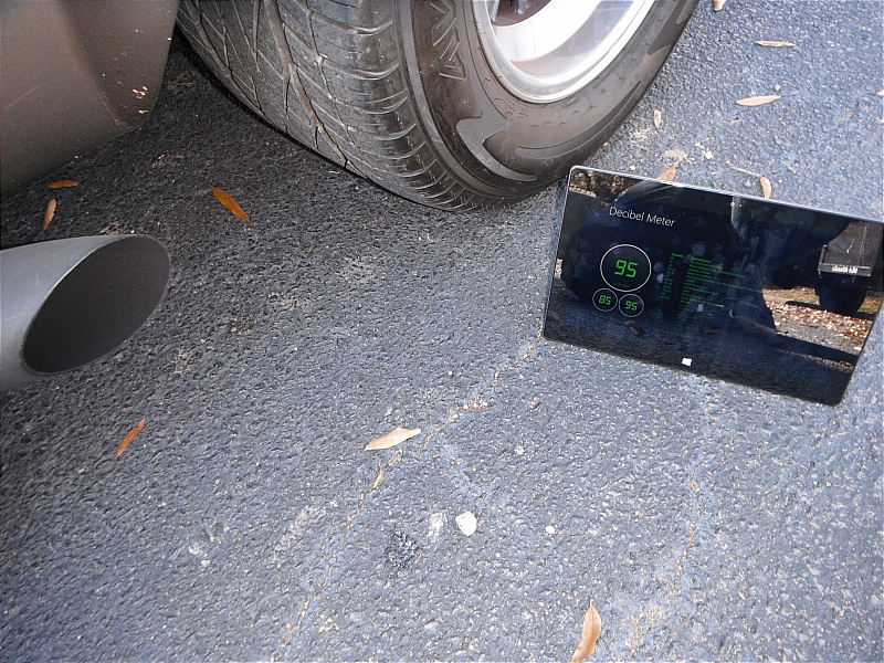

That's going to be a toughie.... I have the "quiet type" pipes on my ERA and she idles at just under 95 decibels.
