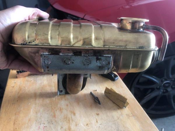

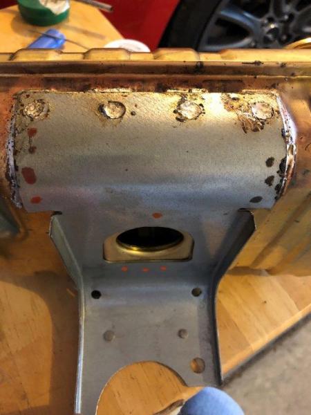

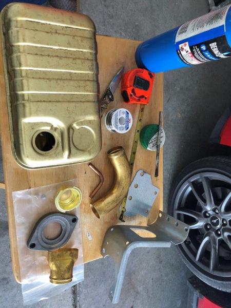

A small project assembling an FE expansion tank to keep me busy while I wait.
I purchased the unassembled kit and spent a few hours putting it together.
It needs pressure tested and painted. I need to pick up a valve stem to fab up a pressure test fixture.
Difficulty level 2 out of 5.

Nice work. Anything special you soldered it together with?

I modified my tank for my KC 482. I was plagued with solder leaks afterwards. I disassembled the whole tank, cleaned all the soft solder off , fluxed and re-soldered it with 15% silver solder. 10+ years later not one leak.

I used 40% tin and 60% lead acid core and lots of flux. The solder flowed nicely and filled all the empty spaces. I pulled on the brackets pretty hard and they are solid.

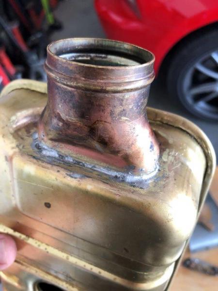

Eight or 10 years ago I bought a new expansion tank from these folks:
https://classicfordradiator.com/61-6...sion-tank.aspx
I wanted to powder coat it but knew the solder melt temp was less than the powder coat cure temp. I 100% disassembled the tank, bought some lead-based solder, some flux and used Bernz-O-Matic propane torch. I melted off and cleaned off all the original solder and rebuilt the expansion tank with the lead solder. And then I powder coated it. No leaks these many years later.
