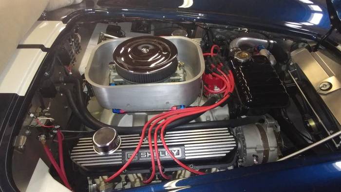

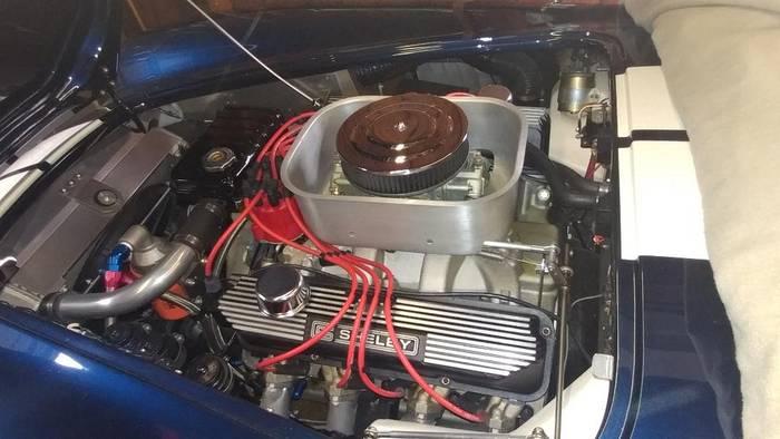

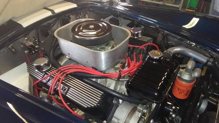

sgianino 02-10-2023 04:54 PM
http://www.clubcobra.com/photopost/d.../enginebay.jpg
http://www.clubcobra.com/photopost/d...enginebay1.jpg
