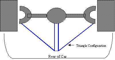

1) Any chance of coming up with some sort of rear trailing arm configuration that would help to resolve this for good? I converted my last Unique to a rear trailing arm and center bar isolation setup. It was like a right and left triangle configuration, side by side. It completely changed how my car launched and came out of turns under throttle. No wheel hope and more stable after installed. http://www.clubcobra.com/photopost/d...9trgconfig.bmp

The AMP setup is meant for a solidly-mounted differential, as is the leading arm design of the Unique design. Neither will work well (or at all) on the ERA subframe. The AMP design puts high stresses into the top bushings. The leading arms bind against the trailing arms and will simply not physically fit.
