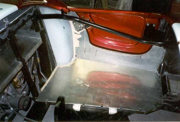

Not sure what area of the door you were looking for, but here are a couple shots of the top lip of the door on my car:
The first one shows the rolled edge of the door, before I applied paint to the inner panel. I ended up spraying the inside with aluminum silver paint - I had contemplated riveting or bonding a small sheet of aluminum there, but decided paint would work for the effect I was looking for.
The next shot shows the opening and profile of the roll on the edge (and the silver paint):
I hope these help. If you need other angles or shots, send me an e-mail, and I will send them to you.

Thanks Jeff, that does help.
BTW, isn't it tight in there with that extra bar next to the door?

No, the bar doesn't seem to intrude or make it feel "tight". It actually provides a good "arm rest" inside the car. It also is very helpful for climbing in and out of the car - makes it much easier to "lift" myself out of the racing bucket seat (couple more helpings of turkey and apple pie, and I'll need a pry bar to get me back out of that seat ).
The extra piece of mind I feel as a curious on-looker on the highway drifts (unconsciously) closer to me trying to get a better look at the car...well...that's PRICELESS!
