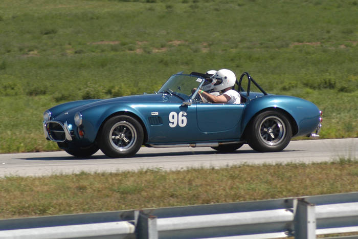

P.S. Here is a picture from the open track taken by Patt Buell!
