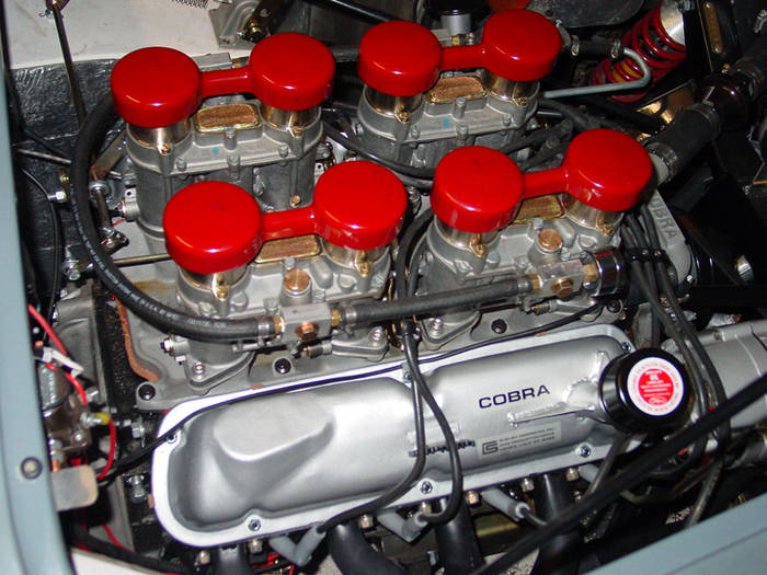

The External looks right. I'll Try to find a better pic for ya. Look up & call Wilson Manifolds. They sell the inline housing as on my car(upper right of pic)

Here it is

Posts: 2,151
Gotta Make em yourself I did a lot of eye ballin' & estimatin'. Found me a decent set of used covers, bought the breathers to figure the diameter of the stacks. Then started patchin', cuttin' templaten' They turned out pretty decent. A quality welder would probably cuss me out a few times for my lack of clean welding but i figure these probably were made for racing & not so much for beauty back then anyhow
Hyde D. Baker
