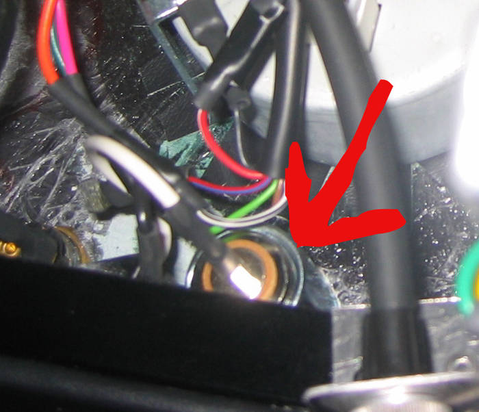

The lighter I have has a black wire coming from the center which has a circle shaped tab on the end of it. Then on the lighter itself there is a tab molded into the lighter. I know enough about electricity to know black is universal for ground but then I though if I connect the power to the tab that would make the entire lighter hot...so...either I am confused which is possible or the black wire coming out of the center of the lighter should be a different color.

Absolutely not true. In your house wiring, for example, your black wire will be "hot," your white wire will be your neutral return, and your green wire (when you have one) will be the ground. You can not rely on the color of the wire to tell you what it's for. That black wire may very well be the 12v positive connection.

ok, so I am wrong. First time today! Ok but here is the issue that led me to thinking this way. The black wire has a circle end (sorry, don't know the proper term for this) which leads me to believe it should be grounded to the chassis. Is it possible the end on this wire is incorrect for my application? I have to assume this lighter is for a universal application.

Possible? It's actually "more than likely." Here is the rule that is right 99.9% of the time: Exposed metal will be connected to the 12v negative, the other connection will be the 12v positive. Pull the little lighter out of the socket and put it on the table. Put a VOM across the end of the black wire and the side of the metal socket -- it should show unlimited resistance. If it does, then hook the black wire up to 12v positive and ground the outside of the metal socket. It should then work fine. If there is not an open circuit between the black wire and the side of the socket with the lighter removed, then don't do anything more until you hear from Bob as wiring it up will create a "short circuit."

In the ERA harness, all black wires are ground. (Standard British automotive practice.)
I don't see too many lighters, but traditionally, the outside (case) should be grounded and the center post will be hot. It's quite possible that Jack (I'll blame him today ) didn't put the proper male spade connector on the lighter pigtail.

Here's a shot of my lighter.

Patrickt, thanks for the pic. Mine looks different then yours.
Bob - sounds right on. I'll get the correct connector do as you say.
So this brings me to yet another question. I have a three prong amp meter (Smiths) and the directions say to take an extra ground and plug it into the middle plug. I used the "extra" one from the lighter but now I have to use it for the lighter. Where should I get the extra ground from. I can make one easy enough I am sure.

Because the lighter draws much more current than any of the gages, I would make a separate ground wire from it directly to the ground connection just below the steering column.
