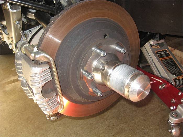

http://www.clubcobra.com/photopost/d...otorpic001.JPG
patrickt 05-04-2009 01:03 PM
You could almost eat off the rear ones...
...and I know you've always coveted my outboard braked rear.:p:p:p
http://www.clubcobra.com/photopost/d...rakepic001.JPG
