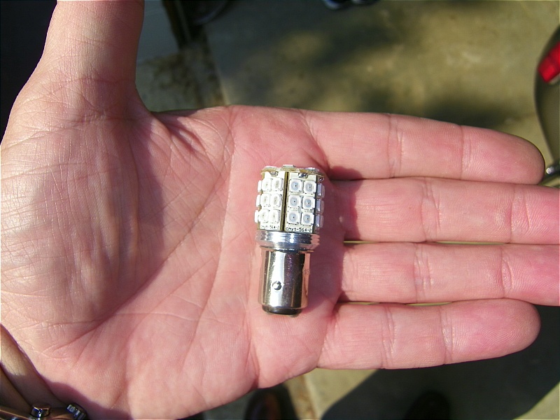

I ordered the RED 1157-R45-T bulb from www.superbrightleds.com -- they have 45 LEDs on them and are perfect for the rectangular, single bulb, rear lights that have the light vertically installed. I had the "extra bright" bulbs in there, along with the reflectors behind them, but the LEDs make a real noticable improvement. It's a five minute installation, and the turn signals work just fine. Here are some shots:
This is the bulb:

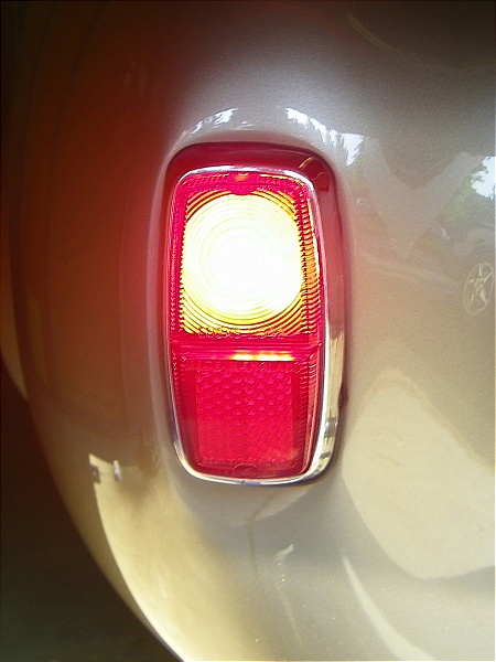

This is the OLD bulb, brakes lit:
This is the NEW LED bulb, brakes lit:
And this is both of them, LED on the left, bulb on the right, brakes lit:

Photos can be deceiving, but in the last photo the LED light looks more amber than red. Will it look red to the driver behind you?

Yes, it's nice and red. All of those 45 LEDs are in fact RED. It's hard to take a picture of a lit light bulb. They also sell an amber bulb just like it, but you wouldn't want that on your rear.

This shot is with the sun directly on the back of the car. Left side has the LED, right side as the "extra bright" bulb. The brake lights are lit, even though it's hard to tell that on the right side.

Patrick - Are the dimensions of the RED 1157-R45-T similar to the stock 1157 bulb?
I'm going to say that the LED bulb is just a hair smaller than the regular bulb. Here's a shot:
