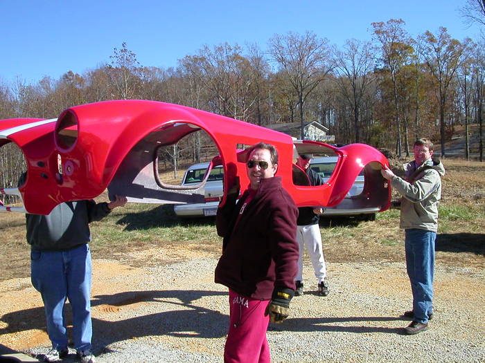

this Hurricane body is light maybe 120 - 140 lbs. You can tell by the picture that nobody is in a strain. We had four guys so we could ease the body onto the frame and not scratch the paint.
two guys can install an unpainted body.
Dwight
