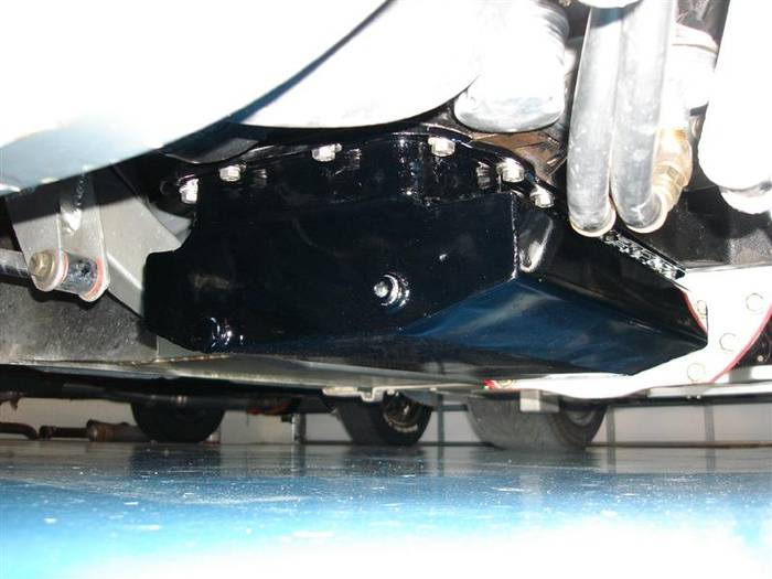

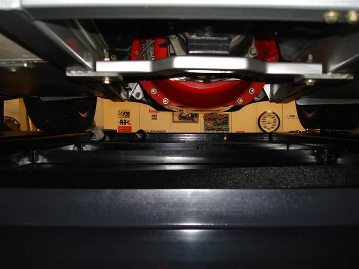

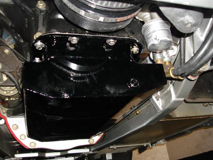

I had Nick Acton (Mickmate on this forum) http://www.actoncustom.com/ build a custom oil pan for my car. The workmanship is awesome. You can trust Nick with any of your custom metalwork needs. I originally had only 2-1/2" of ground clearance to my pan and now I am over 3-1/2". The pan holds 7 qts, I ran 6 with the stock pan.
I found Nick through this forum, and we communicated by e-mail and one phone call. He built the pan without asking for a deposit (which I would have gave him). This shows his honesty. I got progress pics along the way.
See the before & after pics below.
Anthony
Before:
After:

Hey Anthony, that looks good on there. Over an inch more gorund clearance is a lot for us to have gained, that's reassuring from the drivers seat. Now go wash the oil out of your hair you look like a greaser LOL.

The neat thing about Anthony's pan was we managed to shave the height and give him alot more road clearance but retained all the baffling and tricks for the road race pan configuration.
I also have an aluminum FE oil pan flange here I've been just waiting for someone to custom detail to their specs. The plasma cutter doesn't care if it's cutting ally or steel to shape and I like welding either material. Let me know if I can help with your application.
