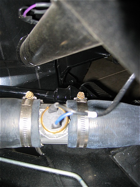

It is just a piece of aluminum tubing with pieces of formed hoses on each end. Very easy to fabricate.

On ERA cars the lower radiator tube also houses the thermo-switch for the fans. It's just a steel tube though. If you can't find a perfect fit hose you could easily duplicate the ERA setup without the thermo switch and the tube would not be noticable.
I think that is what I am going to do. I needed to find a location for my fan switch anyway!!!! I think that tube with the fan switch is a summit part. Does anyone have the part number?
