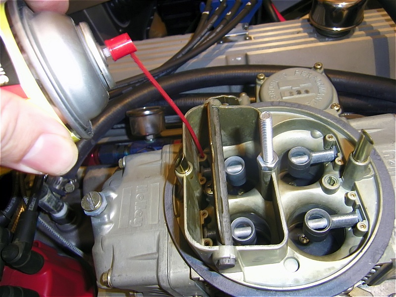

The Holleys have emulsion tubes too, inside the metering blocks and sometimes they can get some debris that will plug up one or more of the very small passages. Squirting a little carb cleaner in the air bleeds as pictured on a regular basis is the cheapest tuneup you can do.

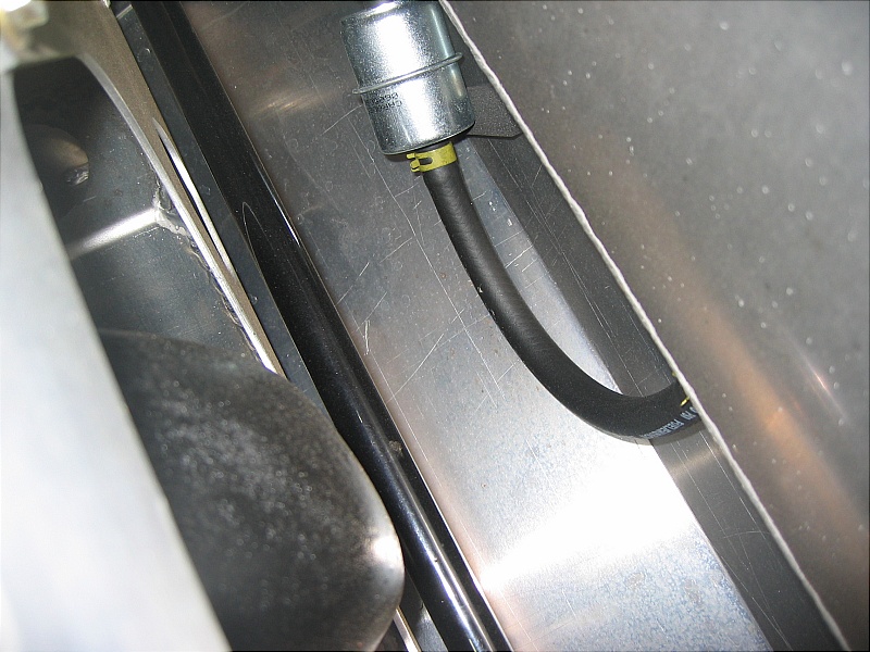

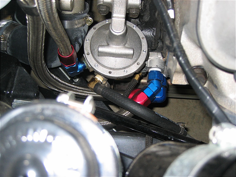

Where are your fuel filters at and is there ANy rubber hoses after it?
Fuel filter at the back adjacent to the tank; rubber hoses on each side. Another rubber hose at the fuel pump (pics below). Will there be anything visible on the outside of the hose to tip me off?
06-06-2010, 05:26 AM
Location: Shasta Lake,
CA
Posts: 26,618
Patrickt,
No, the outside of the hose will look just like it always did. I put a glass type fuel filter right before my carb and only had about a 3" rubber line to connect it to the carb. I have had problems with my weed eater, lawnmowers, and tractor cutting out and that was what it was.
