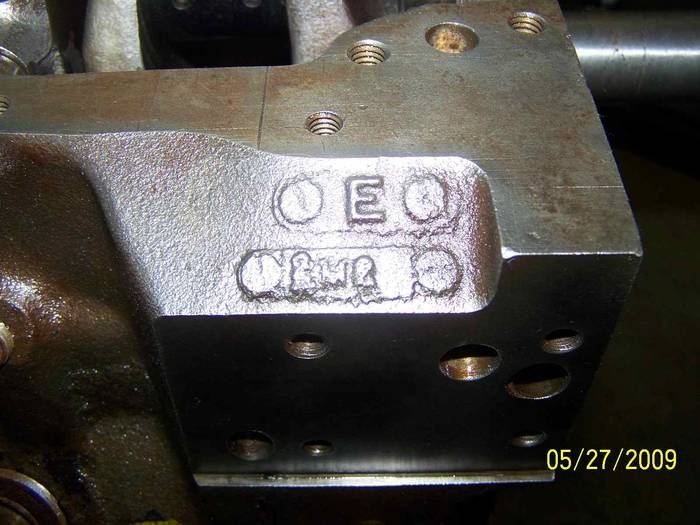

Hello gents - can we dust this thread off for another run? My SPF was ordered thru Olthoff Racing back in 2002 with a 427 SO stroked to 460 with a 428 crank. I'd like to determine the block lineage to see if it's a service block or part of the regular vehicle production that ended in 68. Couple pics attached to start. We have the driver side hump, the threaded freeze plugs and ribs on passenger side - so it appears legit. How can I determine what Ford generation it may be without removing much - or bugging Dennis. TIA

Now that I read the entire thread - I found this below the oil filter block. I believe it's 2L25 - so 11/25/72. Any input? Doug - did you post your block in the pics above? It appears your date is 12/2/72 - a week or so after my block. LOL

Now that you resurrected a thread originally started in 2010, above your starter are actual casting numbers for your block. However, from what I see, it is a 427 sideoiler block as I see the passages and the screw in freeze plugs in your pictures.
