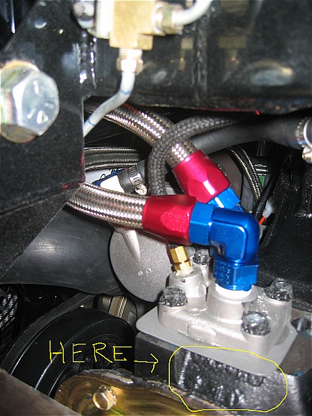

ERA427 -- look, here's a picture of my 428 block and I've circled in yellow where to look. Now I have a remote oil filter, so I have that pretty fitting with the blue and red stainless lines coming out from where an oil filter mounting would normally be. But that's where you should look. I think Bill's message might confuse you, so just look where I've circled and you'll find it. Driver's side, front of the block... if it was a snake, it'd bite 'cha.

Okay so the block is... C6ME-A and the date code is... really hard to read! nuts.
The last two numbers are E2, which means May 2. but the first number looks like a 6 or an 8. Attached.

It's hard to say. That first number could very well be a nine. But after looking at them again, I think I see the "two dots" under the first number, which means it came from the next decade. Maybe that number is a zero with two dots under it, which would make it a 1970 block.

Maybe. Try squirting it with a little rust remover and scrubbing it with a toothbrush sized wire brush. Look for two dots under the the first digit. If you see those, that's a giveaway that it's a 1970 or later.
