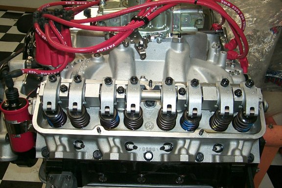

When I designed the Erson roller rockers, the Edelbrock FE heads were just getting started so I designed the rockers to fit standard 390/428 heads. They can be used on Edelbrock and 427 heads but they must be taken apart and shims moved around in order to match the valve spacing of the Edelbrock/427 heads.
Because so many people are now using Erson rockers on Edelbrock heads, we have released a new part number with the rockers already adjusted for Edelbrock/427 heads:
Rockers for Edelbrock/427 heads: E918503
Rockers for standard 390/428 type heads: E918502

It's a brand of roller rockers. Instead of using the regular studs that usually hold the shafts down, they use the head fasteners. Very high quality and very stout.
The Ersons are rated for spring pressures of 800 lbs.
If you ever plan to use a solid roller cam with spring pressures over 500 lbs or so, you'll see how factory shafts and hardware hold up.

They will fit in most valve covers. I guess it depends on what you have. I have a buddy with a set and they fit under the chrome pentroof valve covers.

T&D are great and need about $300.00 of head work to machine the mounting pads flat for the assembly. Jesel also makes a great setup about the same price. Which Ersons fit the Shebly heads? What number? Rick L
