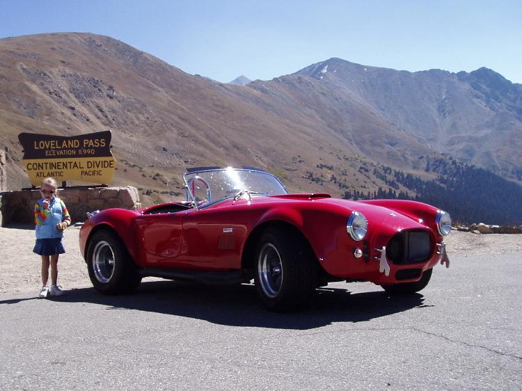

I'm with Al on this one. You will really appreciate it at 11990 ft on a hot day. Welcome to the Mile High Cobras! Holley electric with on/off and switched fan and no ethanol.
[IMG] [/IMG]
