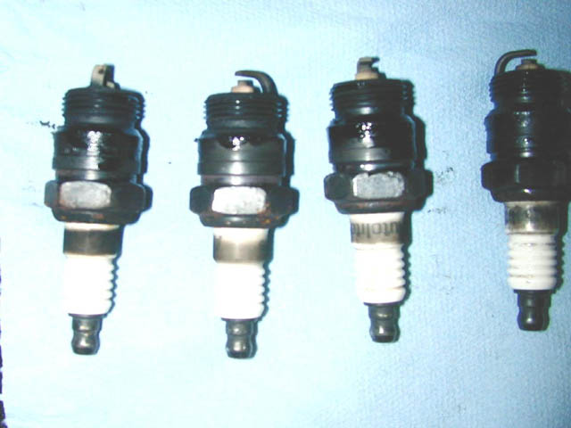

Hi all. Today I took ERA601 for its inaugural drive - which I will cover in general in another thread.
The main thing I would like to solve right now in this forum is a miss when under load - it starts and runs OK, but stutters and misses when the go pedal is pushed. The first thing I did was yank the plugs. Can anybody help in reading these? Are there any clues here?
The plugs are Autolite 45's, gapped to a loose .040". Are these right and gapped right?
The second thing I observed is a noticeable amount of of oil - along the base of the plug thread - see a closer up pic of the right bank plugs below.... Most plugs have it - some more than others. There is not a spec of oil anywhere else on the motor. Is this normal?
I go back to my old engine basics - 95% of all carb problems are electrical...am I in the right area?
I do not know the engine build story (it is new engine - based on the outside, a quick look under the vc's, and based on the rest of the car which has a total of 2k miles), I can't comment on much as to settings - the former owner is somewhere in the slammer, I can't call him for comments.
The car was run about 20 miles and on return to the shop I ran it up to 3k and quick-shut/killed it to shut it off - there was some run on. The plug color seems a bit white to me.
As for carburation...here is all I know....
Comments and any advice most appreciated...

Hi luke-44,
The plugs look good, to me white is good. What your describing to me sound like bad wires. I assume there new though. Check for a good accelerator pump shot,check distributor for good advance, mechanical and vaccum. What kind of ignition are you running? HEI or points? HEI plug gap .045, points .035. At what RMP do you experiance this problem and at what % of throttle. Sounds like maybe the jets are too small (lean missfire?).

What is all the black stuff on the plugs ?
Exhaust leak or leaking valve covers ?
I tend to think you have voltage from the plug wires going to ground down the outside of the plug.The voltage is taking the path of least resistance.

The black stuff, oil above the sparkplug seat is probably valve cover leaking. Try the spray bottle test, plug reinstalled, with the engine running spray water on the plugs and wires. In the dark/garage lights off you will see the sparks jumping off the plugs, or take a jumper wire ground one end and move the other around the spark plugs and look for arching. Looked at the plugs again and I dont see any carbon tracking.

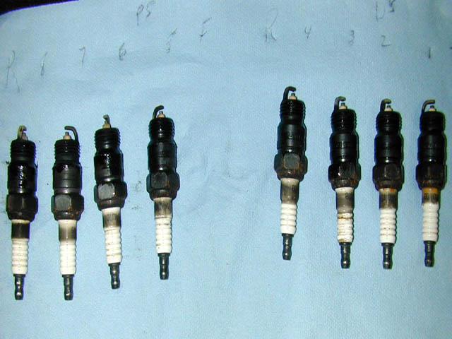

Interesting site on plug reading, but it says that the tests are only valid under certain conditions:
"This is only valid if you shut-off the engine after the finish line then tow the car back to the pits where you remove the plugs for reading !!
Or if you are on the dyno
VALID ONLY for full load acceleration or steady state dyno tests"
Also, I've always been told that you can't really read plugs running today's unleaded fuel like we used to on leaded fuel. True or not?

Hey luke-44, just curious about something else...
Its hard to tell from the pics, but the passenger side plugs look to be coated with a bit more oil. So the question I have is how is the oil getting there in the first place and is this a symptom that also might be related to the motor missing under load?
If all else checks out okay, you might consider looking at the intake manifold to be sure its sealing properly. If not, its also a possibility that you have an intake/vacuum leak going on causing a lean/miss condition under load, and at the same time having oil from the lifter galley sloshing up and getting sucked down into the cylinder head intake ports down into your cylinders on the passenger side. Some Intakes on FEs don't always seal really well if the slightest part of the gasket gets buggered up on the install (which is easy to do).
Do you ever see any type of extra or blue smoke from your sidepipes/exhaust, at any point?

First off white on the plugs in not a good thing. Sounds like it may be a bit on the lean side. The normal color for plugs when everything is right is light tan. Have you tried pulling on the choke as you drive the car? If the car is lean as you pull the choke on the engine will start to feel and sound stronger and the miss will go away. If it is to rich, no way in your case, the engine will start to load up and black smoke will come out of the pipes.
Before you dig into any other "problems" try this. It is quick and easy to to do.
Remeber when it comes to working on and repair or even building cars K.I.S.S. Keep it simple stupid. Words to live by!

One other thought, after looking at your plug pictures....
It appears to me that IF your car is new and has not been run too long or often (is this true?) that you have what appears to be alot of carbon discoloration caused perhaps by blow-by on your plug ceramics?? I notice my plugs do not have this feature after about 1000 miles on them...
As for the oil, it may be that your plugs are showing oil if your mechanic did a compression leak-down test and was less than tidy with spraying oil into the cylinders?? You may want to clean that area up.
Also, your plugs may not have been snugged up enough in the heads? That could account for both blow by of carbon as well as some oil residue? Do not overdo the torque on them though. Does anyone have the actual torque for plugs??
Just a thought...
You may want to use a mirror and a good light and check your plug holes to make sure that there are no plug washers "stuck" to the plug seating area of the heads. Some plugs come with washers others do not. Oil can cause them to stick to the head when you remove the plugs (if yours have such washers).
